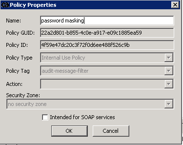

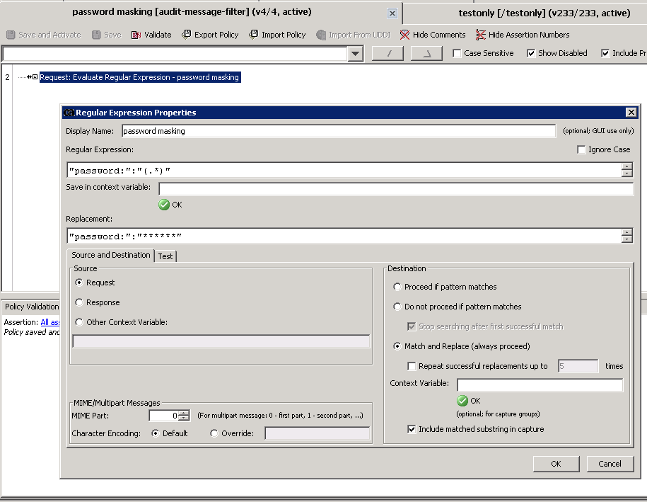

    1. add AMF policy
    2. build the AMF policy , only one assertion in the policy (the regex is as per your request, if your request has different format, we may need to change accordingly to replace the password value to *****)

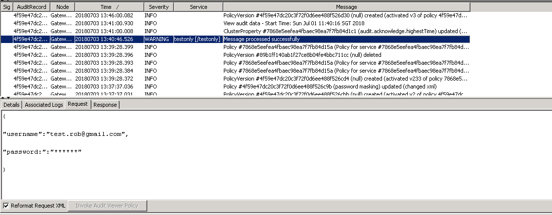

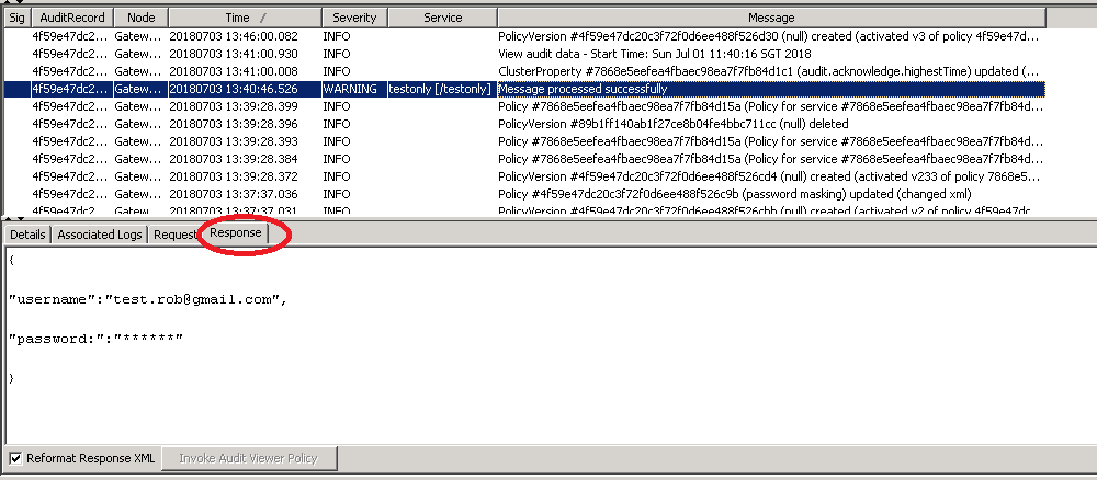

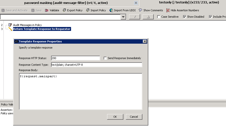

    3. a simple test api
    4. test result in audit event viewer, -- both request and response are masked
    That could be easier than doing it on client side.

    Hi There,
    Similarly i have one more different API for user update, where the gender name field exist in it,i want to mask the filed from the request "Gender": "xxxx". I tried adding Gender regx under the password which didn't trigger masking of Gender filed from request.I also tried creating one more internal AMF policy which does not allow to create one, complains a policy already exist. Pls advice.
