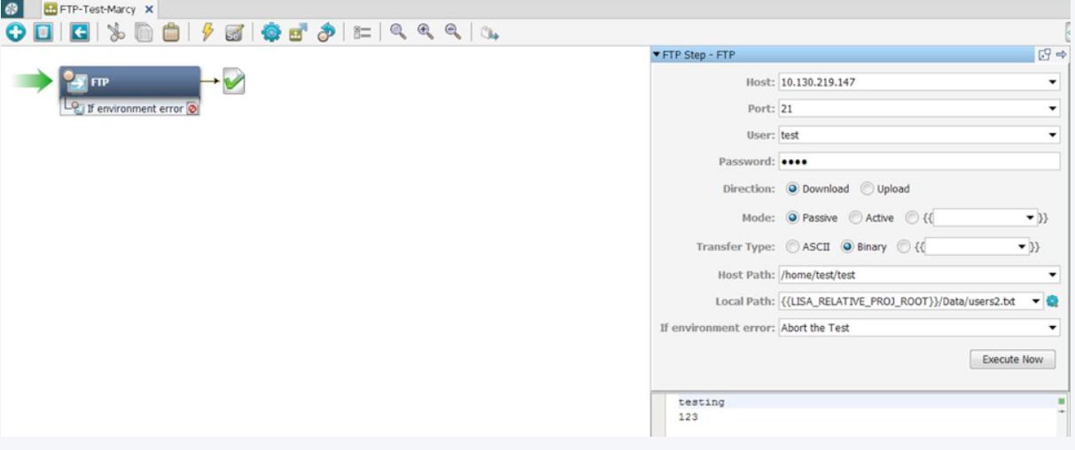

    Have you tried using a FTP step?
    This example below is trying to do a get, but you can easily change to do a put:
    In the below example my Host Linux machine 10.130.219.147.  My User is test.  The file I am wanting to get is also called test and happens to be in my /home/test folder.

    This is my FTP Step:  FTP normally runs or Port 20 or 21.  When I click the Execute Now push button I see the contents of the file are am doing the FTP on.
    For additional information look in the DevTest documentation
    External - FTP Step
