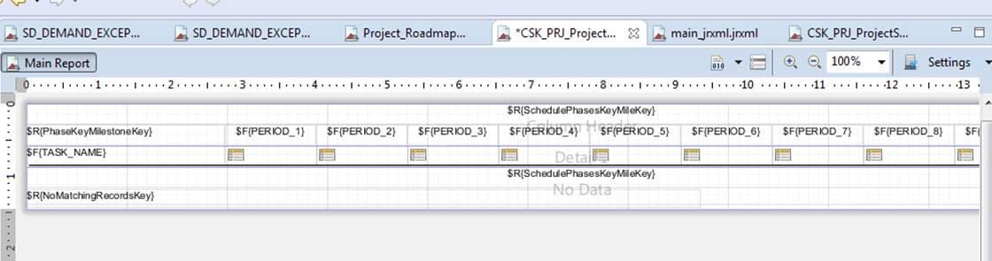

    I think the issue is that you didn't include . jrxml in the name of the subreport.
    When I published your report I didn't see the report that is high lighed in Yellow Below until I added .jrxml to the subreport name.
