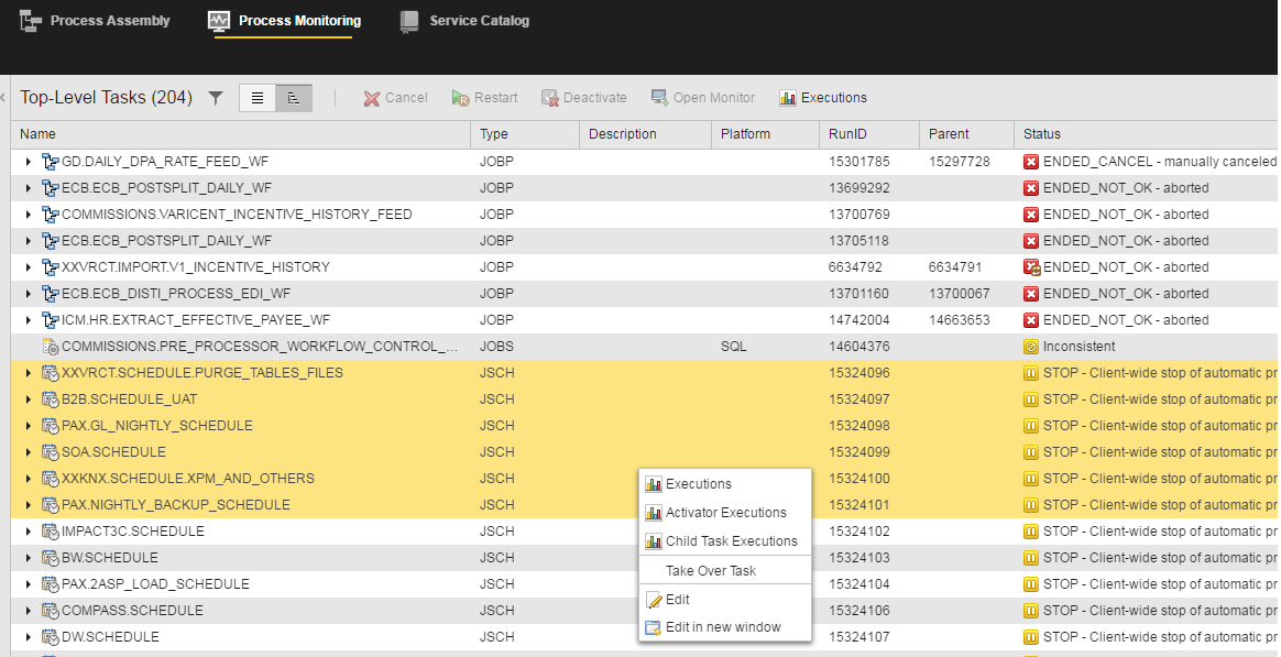

    Hi,
    I've started to use the new V12 AWI and have a couple of questions on the process monitor.
    1. Is it possible to highlight a number of tasks together to take some action on?
    In the Java GUI it was just a matter of using the shift key to highlight a number of tasks together and then take some action. On the AWI it appears that I have to highlight each one separately.
    2. I'm trying to clear out my process monitor which requires removing a number of Schedules.
    See on the attached screenshot, I have highlighted a few but there is no cancel/quit action available for all highlighted.
    Do I need to cancel/quit each one separately?
    John.

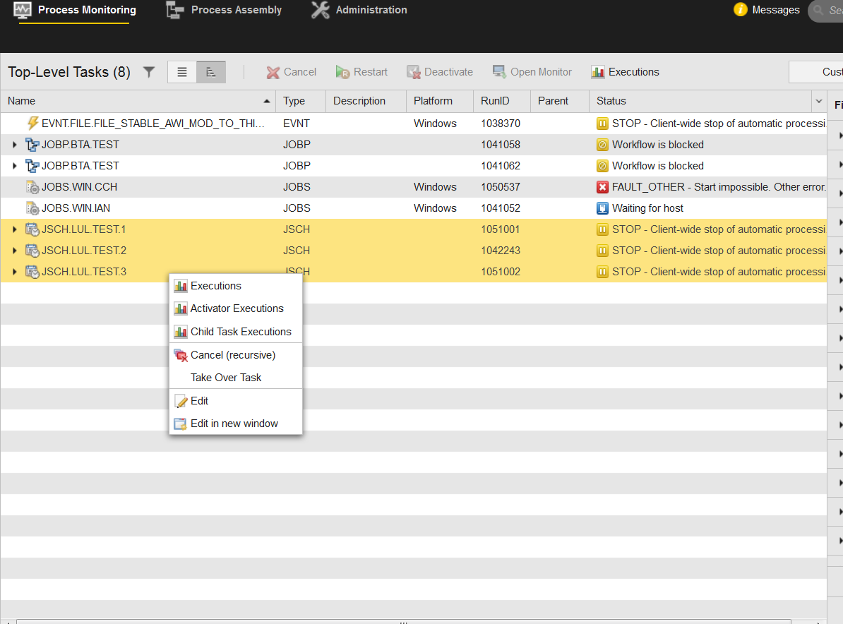

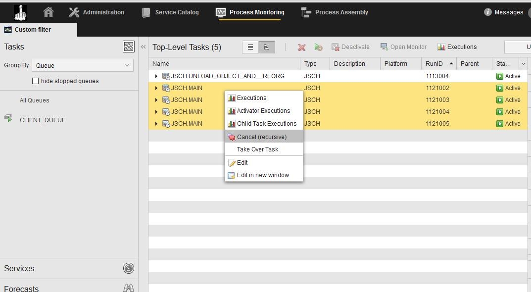

    Hi John
    just played around again with this A.W.I. it worked in my DEV Env.
    1) I marked some jobs by clicking on one and using CRTL+Arrow up/down
    2) the contexe menu appeared in my env
    9sh8431ddf0r.jpghttps://us.v-cdn.net/5019921/uploads/editor/ii/9sh8431ddf0r.jpg" width="1068">

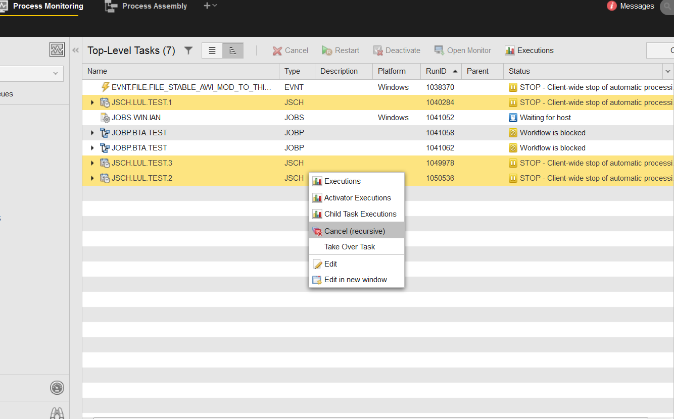

  • 4.  Automation Engine V12 AWI - Process Monitor
    Posted Feb 20, 2017 10:34 AM
    Hi John,
    I tested on my own system with a few JSCH in a client stop scenario and was also to have a cancel option appear (both for JSCH and JOBP).  I am curious on what version of the AWI you are currently on.
    hz6lu6xdbf2z.pnghttps://us.v-cdn.net/5019921/uploads/editor/70/hz6lu6xdbf2z.png" width="1334">
    What version of the v12 AWI are you on?

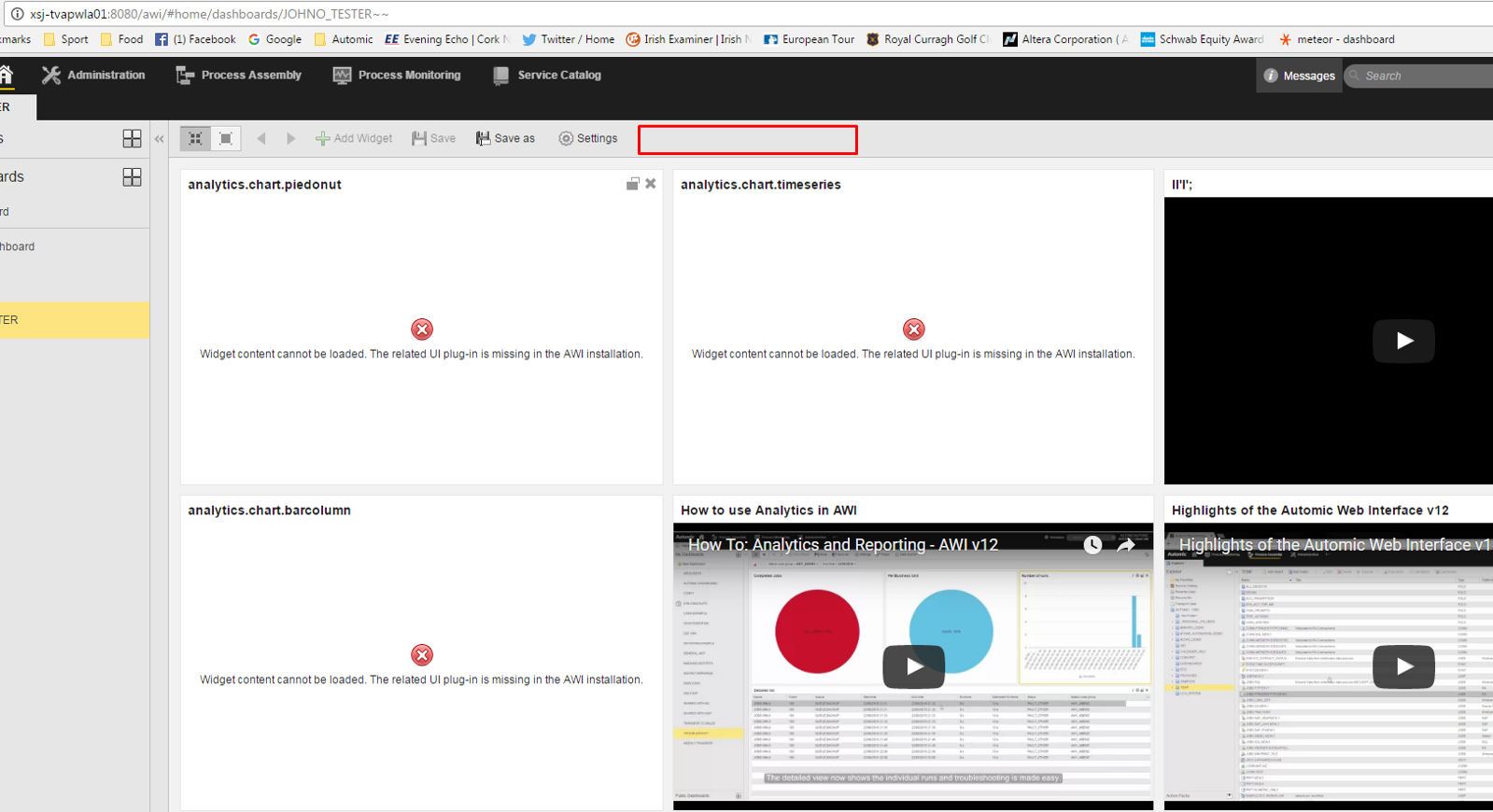

  • 7.  Automation Engine V12 AWI - Process Monitor
    Posted Feb 20, 2017 11:54 AM
    I've just install the latest version of the AWI 12.0.1 HF1
    Now my Analytics widgets are broken and my data source option is missing from my dashboards  :'(
    ohrpjcpwxhmw.pnghttps://us.v-cdn.net/5019921/uploads/editor/g6/ohrpjcpwxhmw.png" width="1600">
  • 8.  Automation Engine V12 AWI - Process Monitor
    Posted Feb 20, 2017 12:49 PM
    Hi John,
    With the new issues you are getting with the the analytic, when you upgrade the AWI.  Can you confirm that the Analytic plugin is configured to your environment per this section of the manual.

    chancelling several JSCH's is absolutely no problem.

    I upgraded "just for fun" to Automic Web Interface 12.0.1.HF01-362 - same behavior as the old version regarding canellation of JSCH's - absolutely no problem.
    Just discovered in your screenshot that your CLIENT seems to be stopped - possibly this causes or influences this issue?

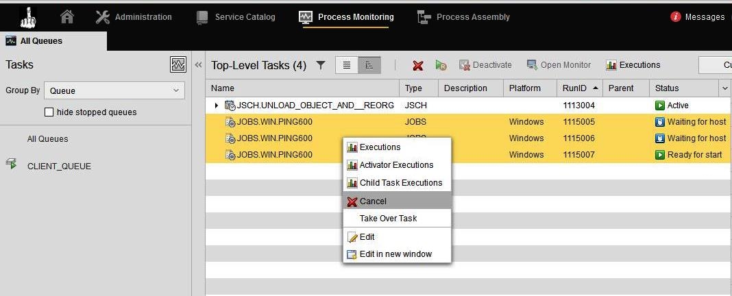

  • 11.  Automation Engine V12 AWI - Process Monitor
    Posted Feb 20, 2017 04:33 PM
    JohnO'Mullane
    I upgrade my AWI to Automic Web Interface 12.0.1.HF01-362 and tested using a JSCH & had put the client in a STOP state, and was still able to have the cancel options.
    iboz6srd9083.pnghttps://us.v-cdn.net/5019921/uploads/editor/7y/iboz6srd9083.png" width="1194">
    So I was wondering, for your particular JSCH that you are trying to cancels - out of curiosity, are they mainly just standard JOBP/JOBS or a combination of that + event and other object type?  Any abnormal status?

  • 13.  Automation Engine V12 AWI - Process Monitor
    Posted Feb 21, 2017 06:41 AM
    Luu_Le_185
    FrankMuffke
    Schedule Issue
    Tested again today, looks good now. Must have just been a glitch in the Matrix :-)
    Analytics Issue
    I looked at a snapshot from my code tree before I installed new AWI and noticed 3 webui_config* files missing in /wla/Automic/External.Resources/apache-tomcat-7.0.70/webapps/awi/WEB-INF/autoinstall/
    I copied them into new install folders and now it works :-)

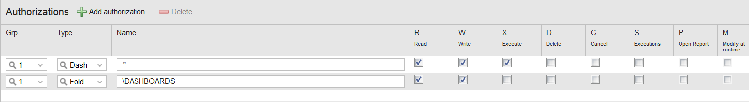

    Hi JohnO'Mullane
    When a user create a dashboard, for the folder it should default to "DASHBOARDS" but you can change/create to another folder if you have access to other folders.
    For my test user (for the sole purpose of creating dashboard) I just had this (+the awi privilege for it to access dashboard) + the following:
    ri1li51puzbc.pnghttps://us.v-cdn.net/5019921/uploads/editor/4q/ri1li51puzbc.png" width="1509">
    In essence it need need the DASH authorization create but also access to XXXX folder to where that object will be created too.
  • 17.  Automation Engine V12 AWI - Process Monitor
    Posted Feb 21, 2017 10:08 AM
    Luu_Le_185
    Gotcha, I just wasn't sure what folder the Dashboards were put. I didn't want to give write access to users to all folders.
    Thanks.
