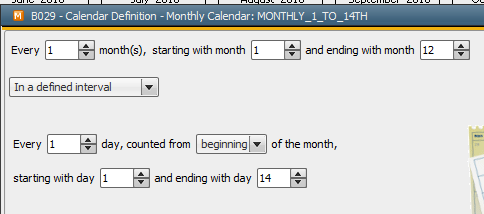

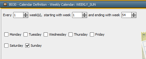

    Create a CALE object and use it ina Workflow, schedule whatever you want...
    think this would be ok:
    Define a weekly keyword active on sundays
    And a monthly keyword active from 1st to 14th
    And combine it in a group object
    Thats it...

    Thanks Wolfgang Brueckler For your response and above is the process which i required at my end.
