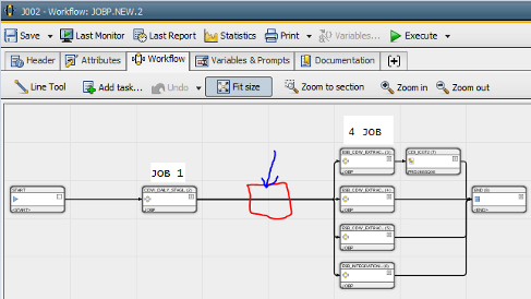

    We have a workflow JOBP.NEW.CFV_DAILY_RUN inside the schedule ESB_CFV_DAILY_SCHEDULE which is running daily.
    In that, Currently we are adding a job manually inside JOBP.NEW.2 workflow on every Thursday, 23rd of every month and last day of every month as shown below
    what I have planned is to place the Workflow in between and apply the calendar to achieve the dates it needs to run on.
    my confusion is with dependencies, As for now the other 4 jobs are dependent on JOB 1.
    Requirement is for all the other days, these 4 Jobs should be dependent on JOB 1 and on Specific days(as per calendar) these jobs should be dependent on Inserted Job.
    Please let me know the most accurate way to automate this to reduce the manual effort of inserting the job everytime it is required to.

    It is OK to have the 4 jobs always wait on the new job.  On off days, the new job will return a 'skipped' condition.  And skipped qualifies as an ANY_OK outcome so the 4 jobs will still run.

    I would install the new job the same way you do now on the last day of every month.  But in addition, go into the new jobs task properties and go to the Calendar tab to set its calendar rules.

    what about the dependencies, how they will switch according to days.
    So currently the 4 jobs which are there depend on ENDED_OK status of JOB 1
    however on these specific days, these 4 Jobs will need to depend on ENDED_OK status of New job which we insert.

    I would look at making the new job an else skip condition on the calendar keywords. Then the down stream jobs I would use ANY_OK which is satisfied by the SKIP condition

    yes you can set the condition ANY_OK which includes all good conditions or if you don't like ANY_OK you can use ENDED_OK_OR_INACTIVE. This will cover exactly the two conditions

    can I put 2 conditions on the successors as below
    JOB1 : Ended_OK
    Job2 : ENDED_OK_OR_INACTIVE
    and successors will only execute if both of these conditions are true.

    Well task 2 should require ENDED_OK on task 1 and all the downstream tasks from 2 should have ENDED_OK_OR_INACTIV

    yes you can define a dependency from JOB1 and another dependency from JOB2. Each dependency can have a condition as you mentioned
