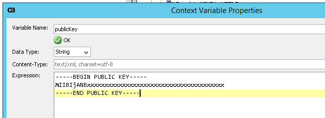

    We have tried populating this in a context variable as follows (note: not a certificate, so we cannot import this in the Manage certificates screen):
