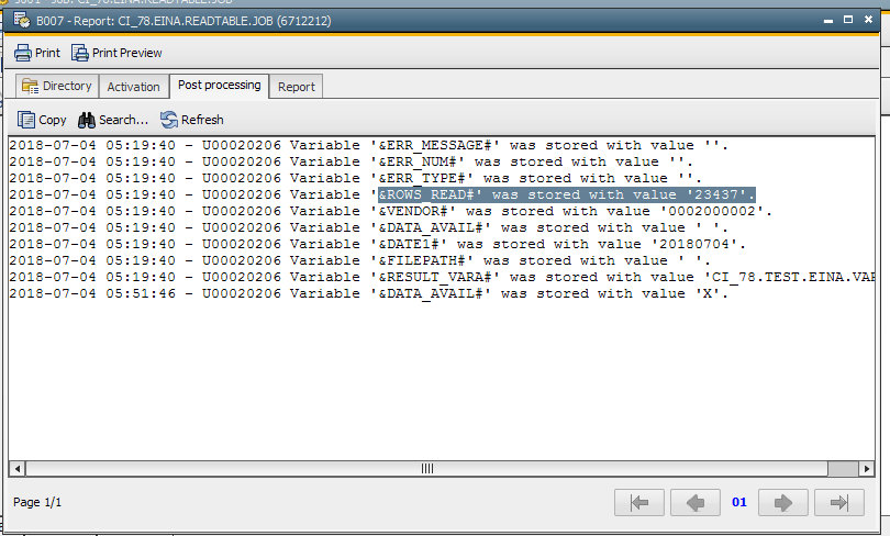

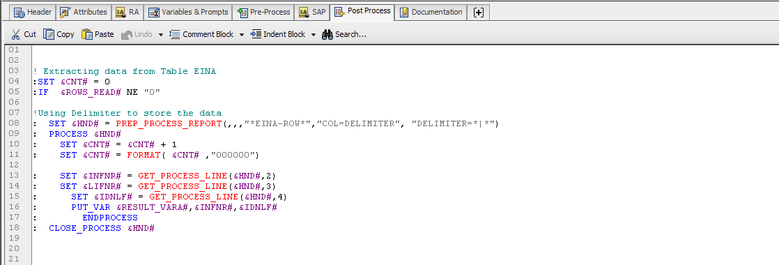

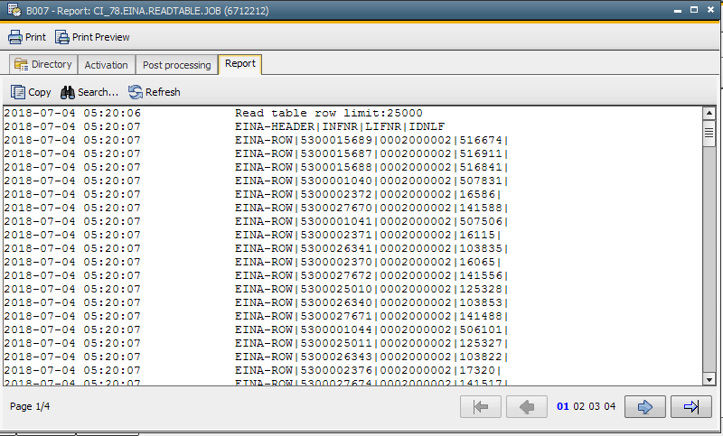

    Hi @Wolfgang. Below is the script I am using to store the data in vara.
    For the above script I am getting in the last report(Post Processing Tab) as the no. of records as 23437.
    Whereas is in Report tab I am getting 13200 records.
    So finally in the vara I am getting 13200 records.

    Hi
    strange...
    You can put a GET_PROCESS_INFO below the PREP_PROCES_XXto check how many Rows it would process, just for debugging purposes:
    :SET &LNR# = GET_PROCESS_INFO(&HND#, ROWS)
    : PRINT "Amount: &LNR#"
    cheers, Wolfgang
