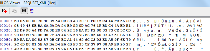

    Dear community,
    I would like to make a string search inside the request or response xml,  which are stored in audit_main table.
    However when I look up into the blob columns, all I can see is the following lines.
    Is there a way to convert or search inside this blob column?
    Kind regards.

  • 3.  Re: Search string in gateway audit request(blob)
    Posted 10-22-2018 10:22 AM
    Dear Seiji_Moriyama,
    You can check the following screenshot for audit_main table.

  • 6.  Re: Search string in gateway audit request(blob)
    Posted 10-22-2018 10:25 AM
    Dear Zhijun,
    • Unfortunately I do not have the audit_message table .
            You can check the table details from the image I have posted above.
    • I only have audit_detail and audit_main tables
    Regards
  • 7.  Re: Search string in gateway audit request(blob)
    Posted 10-22-2018 12:16 PM
    From the screen capture, you appear to be using the Audit Sink policy writing to a database. The location may differ to the audit_main table as we only use 2 tables in this scenario. You should be able to use the uncompress function against the columns outlined in the screen capture.
    Sincerely,
    Stephen Hughes
    CA Support
  • 8.  Re: Search string in gateway audit request(blob)
    Posted 10-22-2018 06:34 PM
    I see. It seems you are using external database to store the audits, the schema is different with the internal mysql database, it only has 2 audit tables.
    If your external database is also mysql database, you can still use the uncompress fuction,
    select uncompress(request_xml), uncompress(response_xml) fromaudit_main;
    If your external database is not mysql database, you may need to check with your DBA or relevant document to see if there is similar function.
