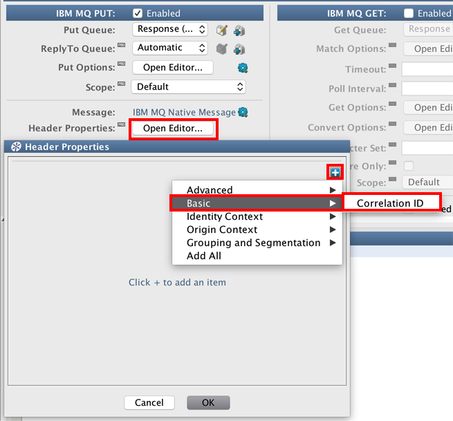

    Go into the respond step, beside 'Header Properties', click 'Open Editor.  Click the '+' button, and select 'Basic' -> 'Correlation ID'

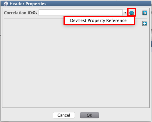

    Beside 'Correlation ID', click the gear icon and select 'DevTest Property Reference':

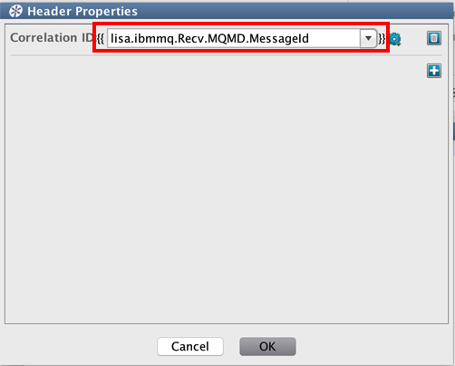

    Enter the property name: lisa.ibmmq.Recv.MQMD.MessageId
