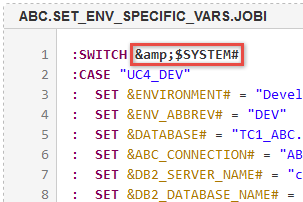

    Hey joel_wiesmann_automic, any chance you could update this to handle predefined variables like &$SYSTEM#? Currently, the syntax highlighting seems to handle these in a strange way, rendering the ampersand as its HTML entity & instead of a literal ampersand.
    I’m guessing this involves editing this line, or adding another one like it just for predefined variables.
    { regex: /&\w+#?/g, css: 'variable' },
    Update: I fixed this by adding the following line:
    { regex: /&\$\w+#/g, css: 'constants' },

    • Added regex for predefined variables such as &$SYSTEM#. Predefined variables are treated as constants.
