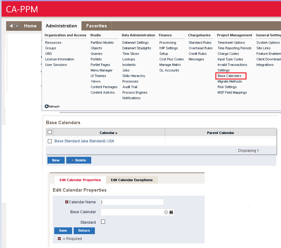

    Thank you. Related Question - Can I set default Calendars similar to the way I do in MSP? Also since I have project team members in several countries can I set regional calendars? ie if I am a French employee my Holidays are X.
  • 7.  Re: New Task
    Posted Oct 31, 2017 12:30 PM
    Yes (if you are an admin), you can create a new calendar and assign the resources to that country specific calendar.
    NJ
  • 8.  Re: New Task
    Posted Nov 04, 2017 07:56 AM
    Another autosaved, but unposted reply from Oct 31.
    In the recent versions there are no longer project specific calendars. All projects follow the Base calendar.
    Resources can be associated with custom calendars. As Navz Joshi points out with administrative rights you can create custom calendars.
