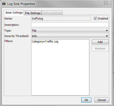

    1. Tasks > Manage Log/Audit Sinks
    2. Click Create on the right side of the window
    3. Name the log accordingly, and check the Enabled checkbox
    4. Add description to the log
    5. Set the Type to File or Syslog, depending on your desire
    6. Choose Severity Threshold as Info, unless you are familiar with our logging levels and want to change. Most events will happen from Info - Warning, so recommend to keep at Info
    7. In the Filters section, click Add, and choose Traffic Log under the first filter dropdown called Category

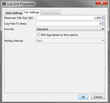

    8. Clicked on the File Settings tab at the top of the window, and choose values accordingly

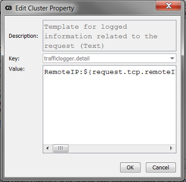

    10. At the top of the Policy Manager go to Tasks > Manage Cluster-Wide Properties
    11. Clicked Add on the right hand side of the window
    12. Clicked the Key dropdown menu and scroll to the bottom to find trafficlogger.detail
    15. You click OK to close this window as the Traffic Log has been fully set up.
    Log file generated as below but no data even tried to hit service many time .
    -rw-rw-r-- 1 gateway gateway 57338 Dec 15 12:32 audit.log
    -rw-rw-r-- 1 gateway gateway 0 Jan 5 11:55 audit_0_0.log
    -rw-rw-r-- 1 gateway gateway 0 Jan 5 13:18 auditlog_0_0.log
    -rw-rw-r-- 1 gateway gateway 0 Jan 5 13:23 trafficlog_0_0.log.lck
    -rw-rw-r-- 1 gateway gateway 0 Jan 5 13:23 ssg_0_0.log.lck
    -rw-rw-r-- 1 gateway gateway 13333518 Jan 5 13:24 ssg_0_0.log
    [root@a301-7881-0152 logs]#

    Prashant
    Below flags are must for either the request or responses to be recorded or not, may be you are missing this.  Please check this cluster wide property and set it to true and see if that helps.
    I have the same exact configuration with trafficlogger.recordres=true and I am able to see values in traffic log files.

    Techies -
    issue resolved after restart gateway .
    Note: No need to add any thing in clusterwideProperties it will log default attributes. Incase there is specific requirement to log complete request and response then only need to add .
