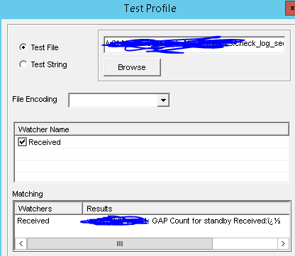

    I am trying to monitor a log file which has just a number written as an output. When checking the content of the file, I can see the values and the same applies when I click on view file on the probe. But when testing, the alert contains values like ?!,!? and not the actual number. Does it have to do anything with the file encoding? I verified and everything seems alright. Any help on this?

    Hi Kag, can you copy an example of the alarm with the wrong characters, an example of the log and maybe a screenshot from the profile

    it should not have any thing to do with encoding if it is numeric.
    But do attach sample from log and logmon.cfg with the profile name you are looking at so we can take a look.

    I couldn't for some reasons get the alert, however the screenshot below is the result of testing the profile. As far as the watchers are concerned, it is just alerting what is present in the target file. Nothing high profile!
    What seems weird, is that there are no logs even when I tested it just before attaching the screenshot. However, I do remember seeing logs sometime back saying that the output target file was not updated. But I am pretty sure that the target file is updated every 2 hours as the script is scheduled to run every two hours.

    anandaguberan unfortunately with the little info it is difficult to diagnose what might be happening. Could you share your cfg and the log from the probe and some additional environment info? (OS where the probe is deployed, Locale of the OS, example of log file monitored).

    This is fixed now. It was a small logical mistake. I enabled the profile with updates mode where in the file will have just a single number being over written. In this case, when I changed the mode to full time it worked.
    Secondly, I modified the file encoding to UTF+8 which gave the right result.
