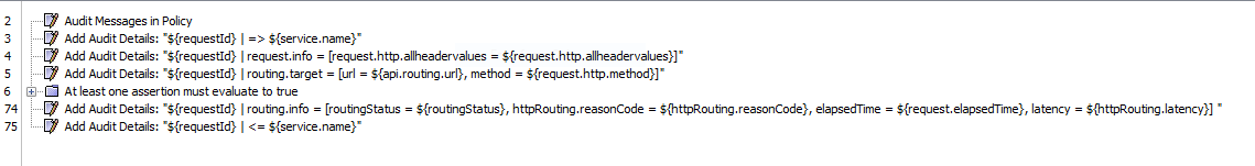

    FWIW - I'll share my logging:
    I'm logging using a custom logger to capture policy execution - "PolicyExecLog" for ease of filtering.
    Here is a snippet of my standard policy with the relevant logging bits:
    I pair this up with a traffic logger defined as follows:
    ${requestId} | ${ssgnode.hostname} | ${request.http.header.x-forwarded-for} | ${request.http.method} | ${request.url} | ${response.http.status}
