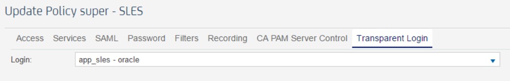

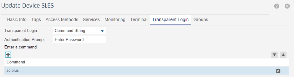

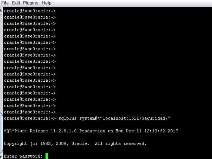

    Hello Juan, You should be able to do this by configuring transparent login using the Command String method, see e.g. https://docops.ca.com/ca-privileged-access-manager/3-0-2/EN/implementing/provision-your-server/provisioning-devices/device-setup . The command string option needs to be enabled in the security configuration as discussed on the page. Otherwise you won't see the option when you edit a device. Once you have it enabled, you can define transparent login on the device page and an account to use in the user/device policy. I added a few pictures on how this would look like in 3.0. This assumes that you use a command syntax like the following, taken from http://blog.oracle48.nl/wordpress/sqlplus-and-easy-connect-without-password-on-the-command-line/, which should prompt for the password:
    $> sqlplus system@\"db_machine:1521/db_servicename\" Enter password: Connected to: (...) SQL>

  • 4.  Re: Can I do an autologin with sqlplus?
    Posted 12-11-2017 04:27 PM
    Hi Juan, Yes, I missed to check on the arguments. You actually have to configure the full command string, not just sqlplus. Given that you have to configure a specific target account for TL, it should not be a restriction to use a specific user name in the argument. The following works for me with a mock sqlplus executable. I added a second command string to cover the case where there could be different access policies with different target accounts defined for transparent login. Also make sure that you use the correct authentication prompt string, there appears to be a case mismatch between what you configured and what the application uses.
