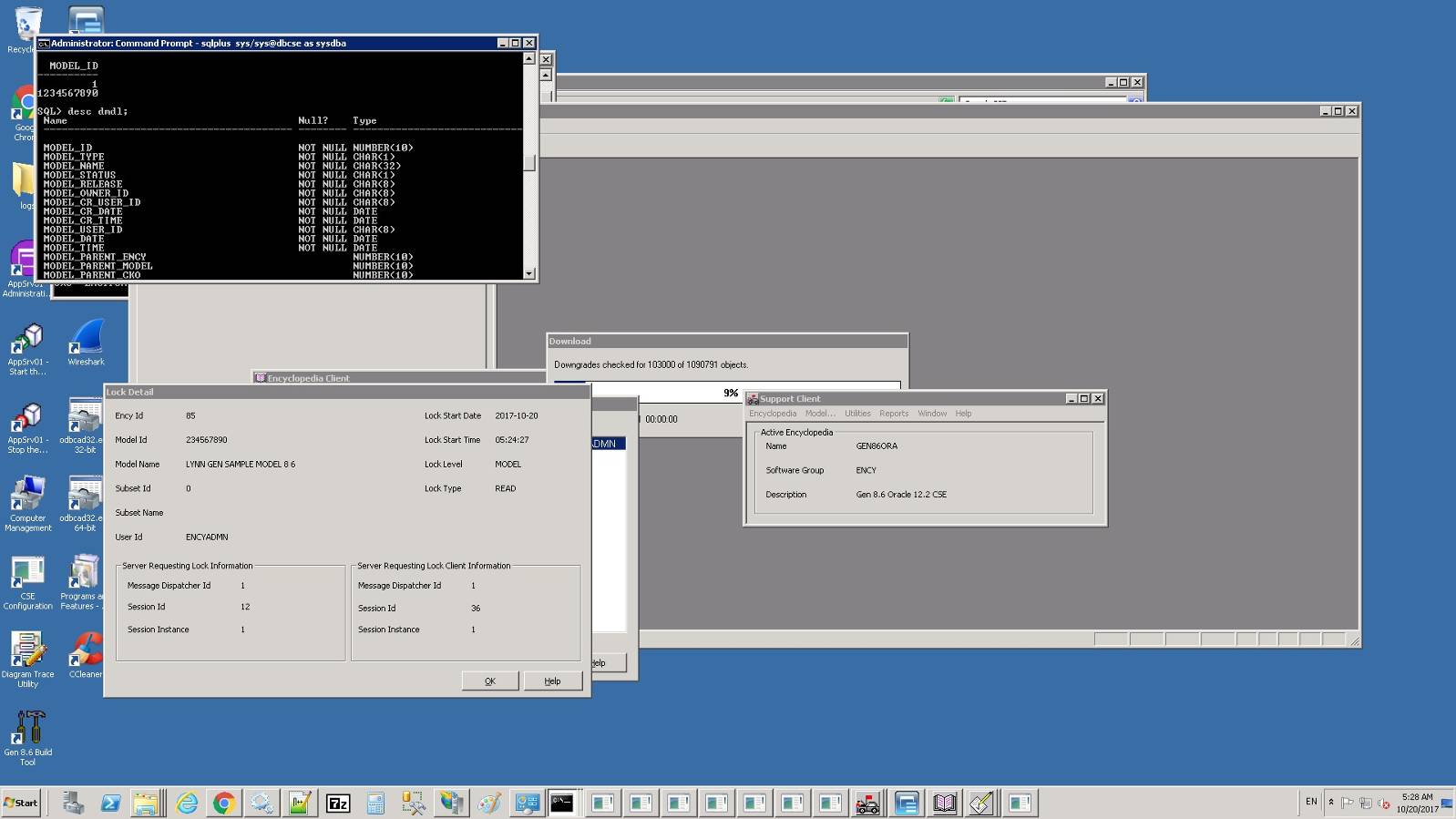

    I just tested on my 8.6 Windows/Oracle 12c CSE after manually updating the model id to have 10 digits i.e. 1234567890
    When I check the Locks during a checkout using the Detail option I see the same symptoms as you reported i.e. the model id loses the first digit and is visible as 234567890
    I suspect this has not been discovered before because it needs a relatively obscure combination of 10 digit model id and either views lock details or using the CSE API.  Also it is only impacting reporting and not the actual stored data.
