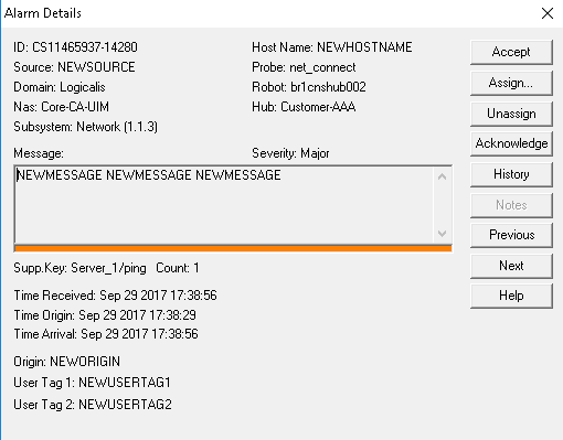

    Hello CA Guys,
    I know that is possible to change alarm values using alarm_enrichment and also using LUA Script.
    But I want to know if is possible change the HUB Value of an alam.
    For example, we can change vairous alarms fields, but hub.
    Anyone have an ideia about how to change a hub value for alarms ?
    Regards,
    Jean Gomes

    HI,
    can you give a use case of why you would want to change the hub value?
    With alarm Enrichment process any field in the alarm can be updated.
    With pre-processing events only a subset can be modified and hub is not one of them.
    I believe the only way you would be able to change the Hub value would be through an alarm_enrichment process.
