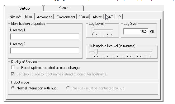

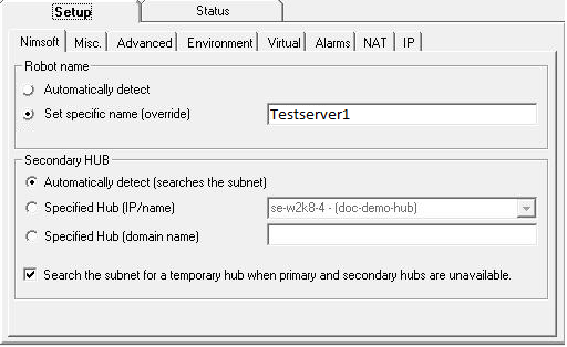

    For around 3 year I have keep configuring controller to override the robot name and set the qos source of the controller function to make the QOS display the robot name only and in lowercase . Then clear the niscache in the robot and use SLM portlet to merge the new qos with the old qos.
