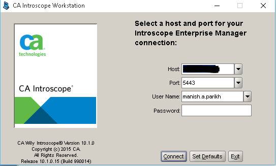

    In prod environment, I use APM Workstation which uses port 5443 to access the UI. I do the exact same for the Dev env but doesn't seem to flag that at all

    This works for cert updating for WebView (port 8443) and CEM GUI (port 8444) but this didn't work for APM Workstation that uses port 5443
