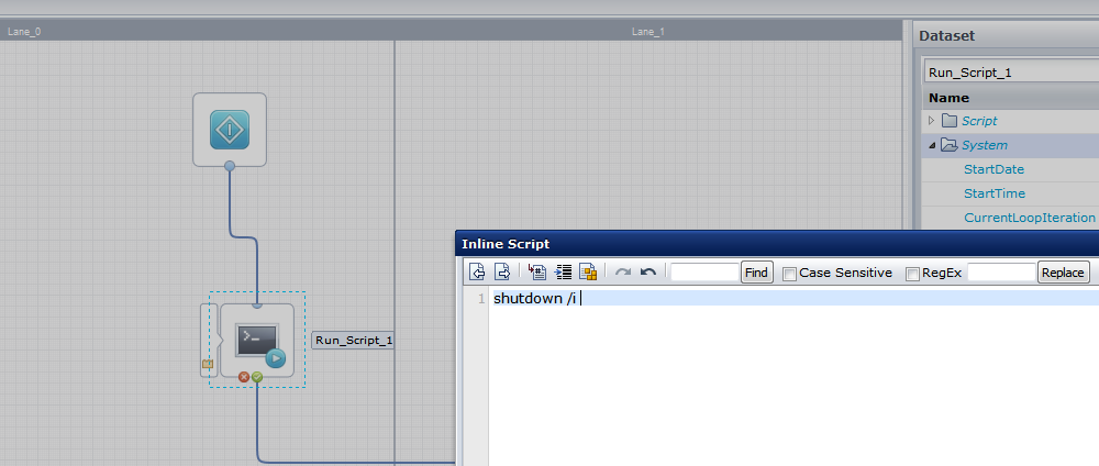

    I am not sure how to advise.  The simplest would be to create a process with a script operator and the command line option to restart the local machine and run it on a remote touchpoint.  For example this process would restart whatever server it was run on:
    This would require agents on any machines you need to restart.

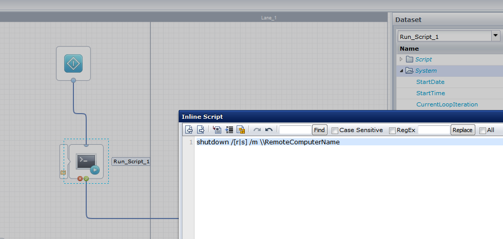

    Alternatively you could issue a remote restart command:
    This process example would call a script operator and restart 'RemoteComputerName'

    If you need to reboot a specific machine that will not be the same everytime you will need to use dynamic values and your script would look something like:
    shutdown /[r|s] /m + \\ + "Process.RemoteComputerName"
    where you are determining the remote machine to be rebooted and setting that as a dataset value "RemoteComputerName" earlier in your process.
