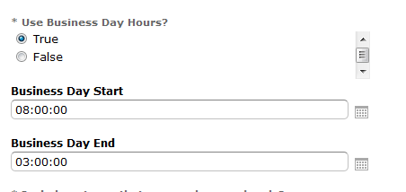

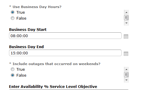

  • 8.  Re: Jasper Report Schedule
    Posted Aug 16, 2017 05:15 AM
    Hello Again,
    the recurrence it was configure properly, the problem that I had, it was at the moment to configure the report parameter, if we use business hours from 08:00 and business day end 15:00 at the moment you save the hour automatically change to 03:00
    configuring:
    after save
    so in order to fix it I wrote 015:00:00 in business day end  instead of 15:00:00. So now it is working perfect.
