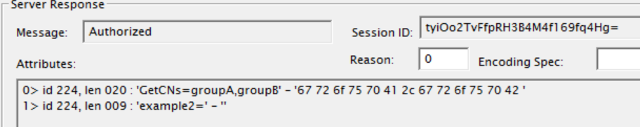

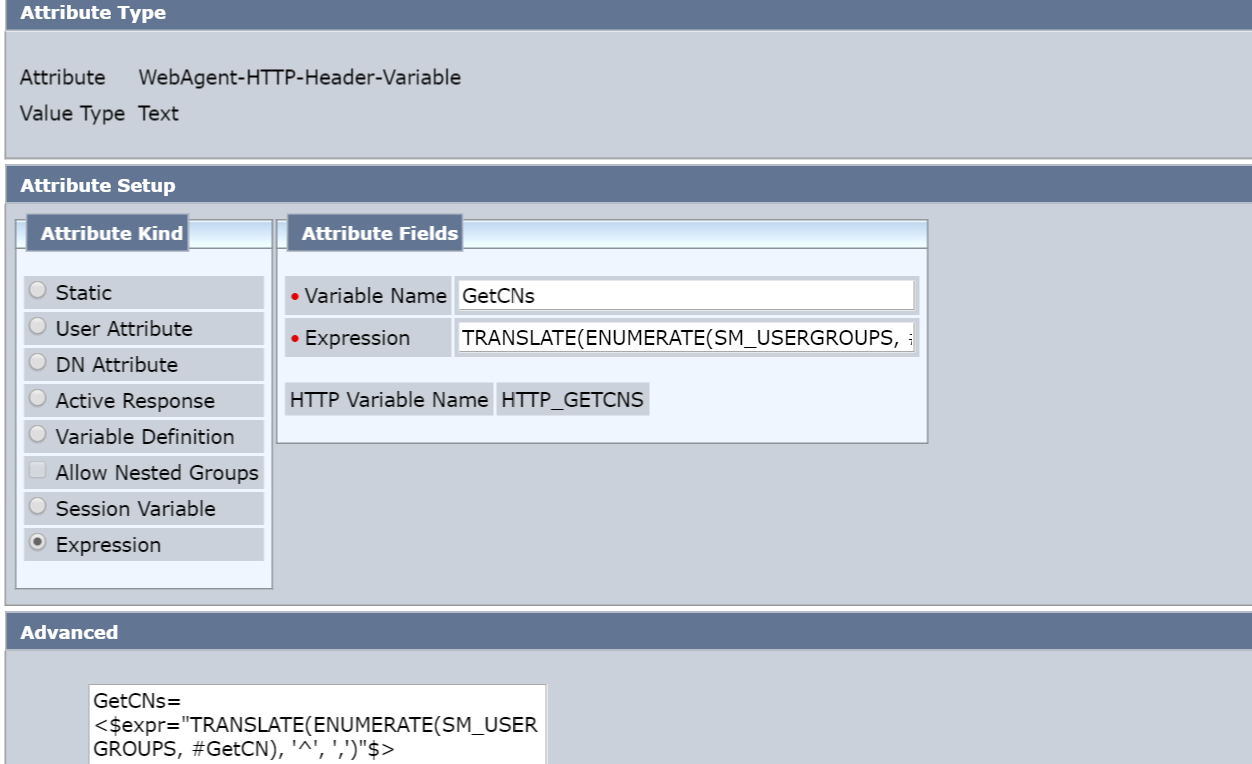

    To get multi-value CN of all the groups, docops Example 1 works.
    Attributes and Expressions Reference - CA Single Sign-On - 12.52 SP1 - CA Technologies Documentation
    Example 1
    Virtual User Attribute #GetCN set to RDN( STRING(%0),FALSE)
    ENUMERATE(SM_USERGROUPS, #GetCN)
    I created an Expression #GetCN and used Enumerate. Example 2 does NOT work.
    Example 2
    ENUMERATE(SM_USERGROUPS, STRING(RDN(%0, FALSE)))
    So putting it all together to get CN with commas I use:
    TRANSLATE(ENUMERATE(SM_USERGROUPS, #GetCN), '^', ',')
    The result is:
