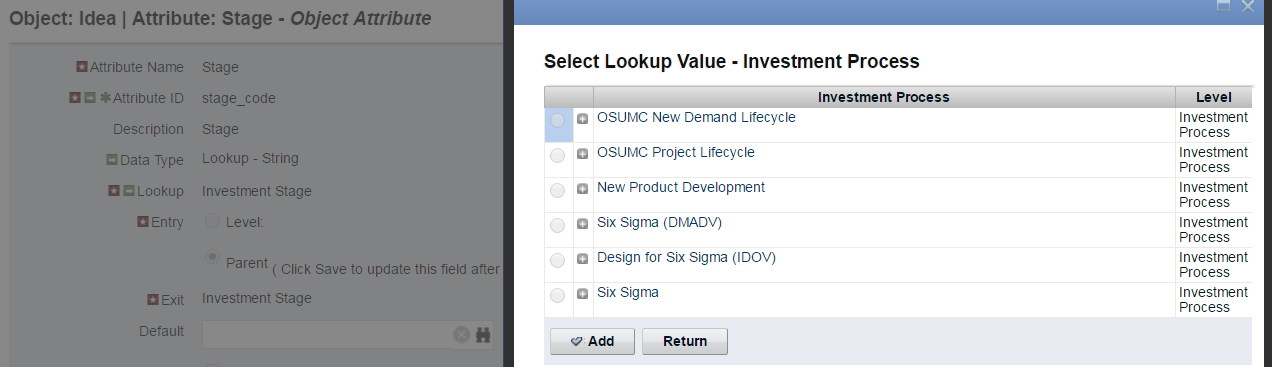

    We're maturing our Demand & Portfolio Management processes. We desire to make a 'hard split' between Ideas and Projects. Ideas being for Demand Management & Project being for Project Management, obviously.

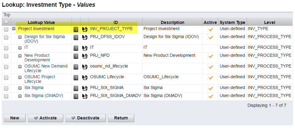

    I notice it is possible to restrict the Investment Process and Stage values (typically what us project management types call lifecycles) to an Object. Service is shown below.
    On our Ideas today, the INV_PROJECT_TYPE Investment Processes and Stages show:

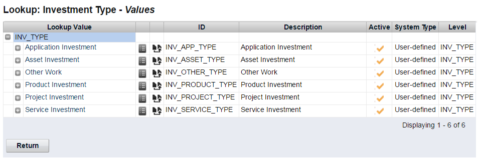

    OOTB (or, our box at least) we don't have Idea Investment Type.
    Nor is there a "NEW" button here.

    2) Is it as easy as creating a new INV_TYPE (INV_IDEA_TYPE?) level? If so...
    3) I'm assuming this can happen via XOG?
    I'm playing around with cowboying stuff in my Dev environment, but I'd prefer not to guess at this. Even if I XOG in an update to this lookup - is the Idea Object 'smart enough' to constrain to the INV_IDEA_TYPE Investment Process or does something else undocumented need done?

    Hi Suhail. The Idea Process Status Type is targeted for use with the process engine (see the Idea Approval process). We're simply looking for getting an Idea specific lifecycle in the OOTB Stage attribute (ID: stage_code) that, when the user clicks browse, presents the Idea lifecycle only. Much like the Applications Object, Services, etc. We reeeeaaly want to stay in the box on the Investment Type lookup (ID: INV_TYPE) and the Stage attribute (ID: stage_code) since so much other functionality in the tool is prebuilt off of Stage. Thanks for digging though!

    While one can get an INV_IDEA_TYPE into the Lookup...
    This is all System Restricted:
    https://www.ca.com/us/services-support/ca-support/ca-support-online/knowledge-base-articles.tec576037.html
    I've been unable to find how I convince the the stage_code to pickup at the INV_IDEA_TYPE as the root node. I can see the INV_PROJECT_TYPE being passed in SQL Trace as well as in the browser debug on the Idea Object's Stage definition. I've been unable to find how I can influence this.
