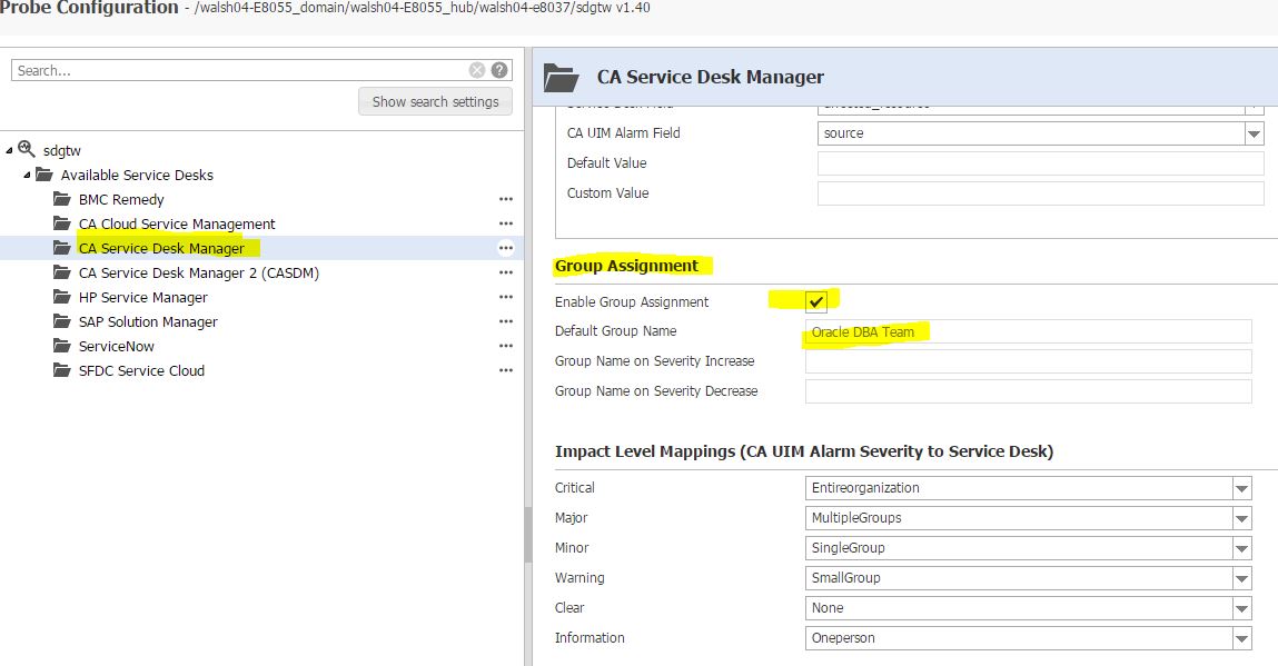

    In this example, we want all oracle probe alarms to create incidents with the Oracle DBA team in CA Service Desk.

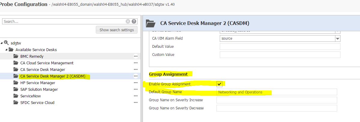

    Secondly, we want all net_connect probe alarms to go to the Network and Operations team in CA Service Desk
    1- Configure the sdgtw probe.
    2- You will have an Available Service Desk for "CA Service Desk Manager"
         Configured that for the Oracle Group.
    3- Now clone that "CA Service Desk Manager", give the cloned one a new name, in this example "CASDM2".  You could also call it something more intuitive based on the group.

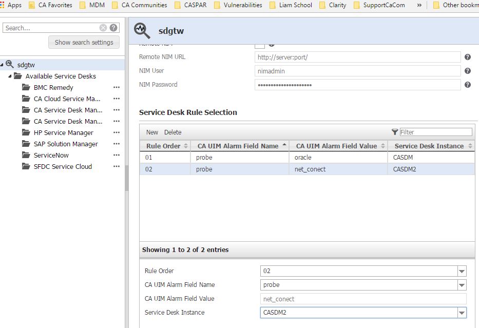

    4- Now, on the main "sdgtw" configuration screen, create rules.
    The rules allow you to conditionally map an alarm field and value, so that if true, they will go to a certain Service Desk.
    For example:
    Hope that helps.
