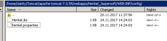

    However properties file has been generated properly and copied to <Tomcat>/webapps/<jasperwebcontext>/WEB-INF/config some time ago according to JS Install and Setup guide:
    Once thing I noticed is that properties file starts with lower "h" however in logs starts with upper "H".
    When tried renaming properties file to start with "H", restarted Tomcat, then JS reports didn't worked in Clarity at all.
    Any ideas? For me very strange from where comes properties file starting with upper H in logs...Moreover, those files are generated automatically...
    Thanks
    Matej

    You dont need to rename the property file, try this
    1. Login to PPM
    2. Go to Advance Reporting --> Users and search for jasperadmin
    3. Edit the user and go to attributes tab
    4. Delete all the attribute
    4. Run the admin update jasperParameters
    5. Then run the Restore Domain job and see if it works
  • 21.  Re: DWH - Incremental Load job failure
