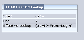

    2. LDAP User DN lookup is NOT correct.
    for. e.g if the user provides username as "user1" then it will effectively try to lookup user : cn=ustore_user, o=ustore,c=INuser1. This is an INVALID DN.
    For CA directory using the uid field for lookup is usually preferred.
    So your LDAP User DN Lookup should look like this ;
    If you choose to look up on uid, be sure to specify the uid for all the users in your user store.
