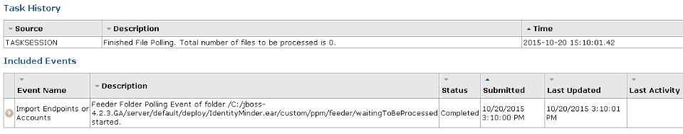

    If you check your PIM submitted task activity (System -> Audit -> View Submitted Tasks) you may find the below event occurring several times per day:
    This events gets logged every time the Feeder Folder Polling event is triggered, so if you would like to minimize its occurrence you can go to
    System -> Connection Management -> Modify Scheduling Configuration and you will find the "Feeder Folder Polling Cron Expression" entry, if you replace its default
    value with the following cron expression "0 0 12 1 6 ? *" you will be configuring the job to be executed once per year on Jan 1st 12pm.
