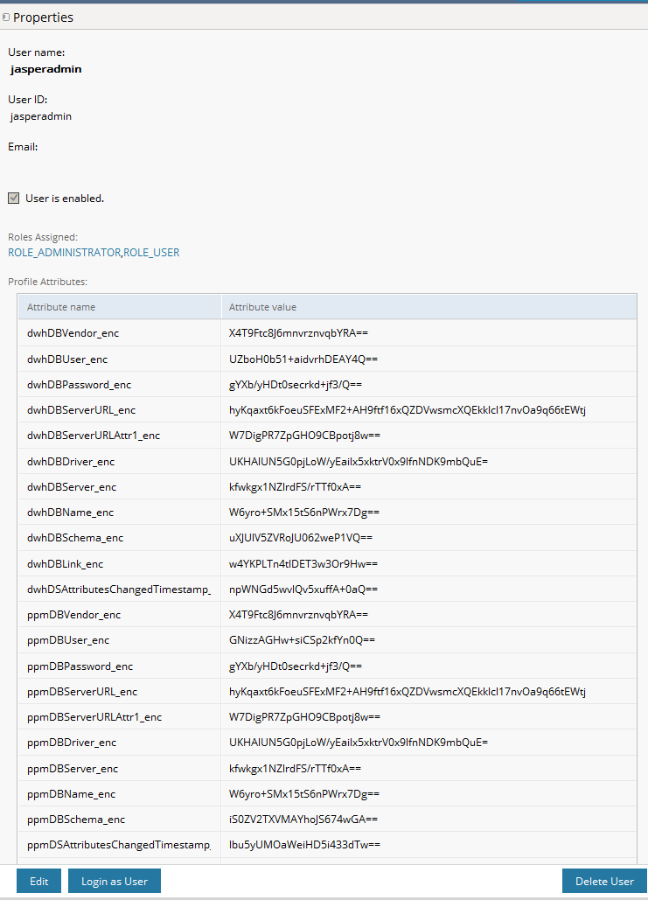

Jaspersoft Parameters Setup (ppmParameters)
If you see that some of ppmParameters is incorrect, for example:
2015-06-15 17:55:10,270 DEBUG EngineServiceImpl,http-apr-8081-exec-3:2261 - Setting report parameter ppmDBVendor to oracle
2015-06-15 17:55:10,270 DEBUG EngineServiceImpl,http-apr-8081-exec-3:2261 - Setting report parameter ppmDBName to clarity
2015-06-15 17:55:10,286 DEBUG EngineServiceImpl,http-apr-8081-exec-3:2261 - Setting report parameter ppmDBSchema to CLARITY142
2015-06-15 17:55:10,286 DEBUG EngineServiceImpl,http-apr-8081-exec-3:2261 - Setting report parameter ppmAppServer to http://claritynam9/niku/nu
The ppm parameters are saved on Jaspersoft level in the details for the user jasperadmin (not ppmjasperadmin, just jasperadmin). Here is how it looks in UI:
If any of those environmental details is incorrect in logs, this means that you will have to reset them.
The properties are encrypted, so you will not be able to see the exact value in UI, but you can note when there is a difference when you update them with the command below.
Run the command
admin update jasperParameters
This will reset the parameters on jasperadmin user to the ones set in the properties.xml file.
