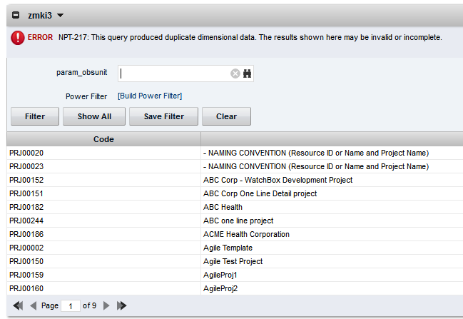

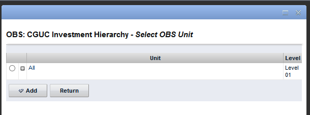

    When I use the lookup in a custom object based portlet it behaves differently
    It puts the association in the filter by default and when I use the filter I have to choose the OBS type first
    When I use the same lookup in a query based portet I do not have the association mode in the filter
    It is in the filter field definitions, but I am not quite sure it works. When using the filter I have to select the OBS type first
    That is if the top one is not the one I want to use.
    The benefit of this lookup is the hierarchy which make is somewhat easier to find the OBS units compared to a custom lookup with exactly the same query which gives there results flat.
    Please educate me: How do I get a hierarchical OBS lookup for a query based portlet so that the user does not have to select the OBS type first.

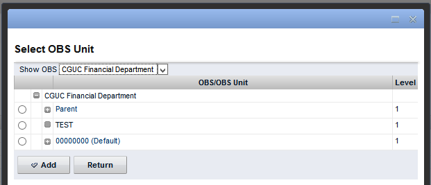

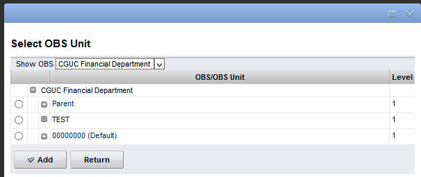

    You can't easily.
    The object-specific OBS filters (like the one for projects OBS_BROWSE_FLT_PRJ, but there will also be ones for other objects that have OBS's associated to them) always look like that and always present the first (alphabetically) relevant OBS-type for that object.
    So heres the trick I think ; find an object type that you are NOT USING - associate it with the one OBS that you are interested in - you now have a system-lookup for only that one OBS type which you can use is custom portlets.

    Dave's suggestion of taking advantage of an object you don't use, attaching that to an OBS and then using its OBS filter in reports/portlets etc

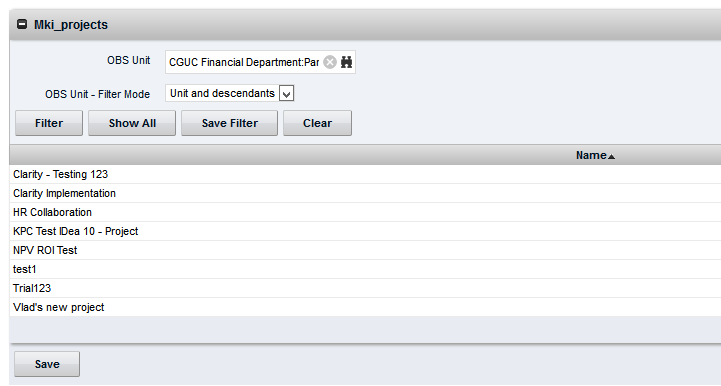

    Well, if you (I, we etc) gotta live with it and it were chosen to use the standard OBS filter because it has the hierarchical display
    - is there a way to specify which OBS to have as default ( and not the first in the alphabetical order and without affecting the use of that lookup elsewhere)
    - does the OBS Filter Mode in the portlet filter field properteis work? I get the results for Unit only also when I select Unit and descendants.
