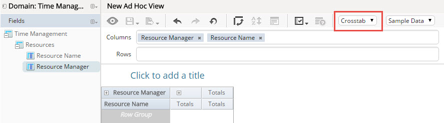

1) Create a new Ad Hoc View from the Time Management domain.
2) Add Resource Name & Resource Manager. Click OK.
3) New Ad Hoc View will default to Crosstab. Add columns as below.

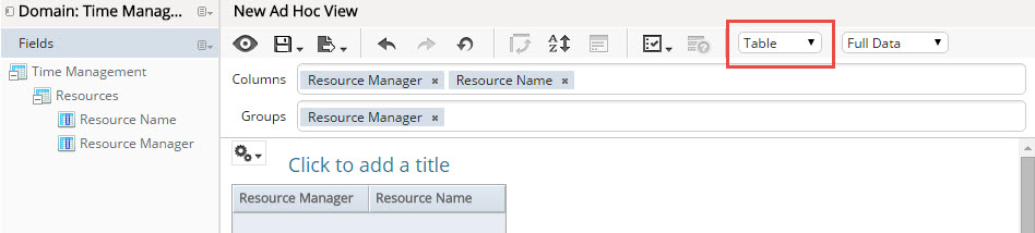

Change layout to Table. Add columns and Group By as shown below.

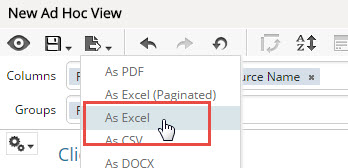

View As Excel
Field Not Found error will be thrown.
