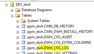

    The table referenced is definitely there:
    We haven't configured Jaspersoft in to our environment at all yet as we want to get a working data warehouse first, so it's not a Jasper issue (unless there's an undocumented dependency we don't know about!)

    From the description it looks like the default schema is not set to PPM_DWH schema, if you see in our install guide we have documented the same
    Another test can prove that, login to management studio and run below
    SELECT * FROM DWH_CFG_LOG; -> you will get invalid object
    SELECT * ppm_dwh.FROM DWH_CFG_LOG; -> should work fine.
    Database Schema Name
    ppm_dwh
    The login name can be anything, but the default schema name for the login user must be ppm_dwh.
    let me know how it goes

    We have managed to run the job now - I'm still waiting for the exact reasons as to why it was failing but it seems to be something to do with the configuration of the PPM_DWH login in SQL server.  If I get more information I'll post it here.

    I had a similar problem, for resolve, you need delete db user or use a new db user with default schema ppm_dwh.
