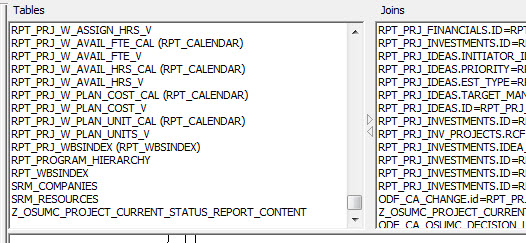

    I guess "updated to reflect database schema changes in Release 14.3" is the big question.
    We're running reports built off of a copy of the original 1.0 universes that we've built into. The only thing that would adversely affect these would be tables that were dropped. The dropped tables listed are all "XBKP" prefixed tables. Looking at the Universes in designer I'm not seeing that any XBKP tables are used.
    Too bad i uninstalled Business Objects in my Dev & Test environments to make room for Jaspersoft or I'd actually be able to TEST this...
    Thanks Andy for helping me think this through - I think we're gonna be OK. I'll report back if otherwise.
