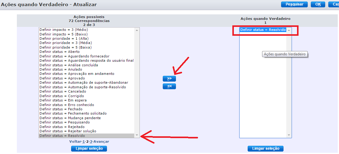

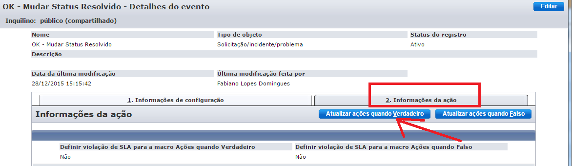

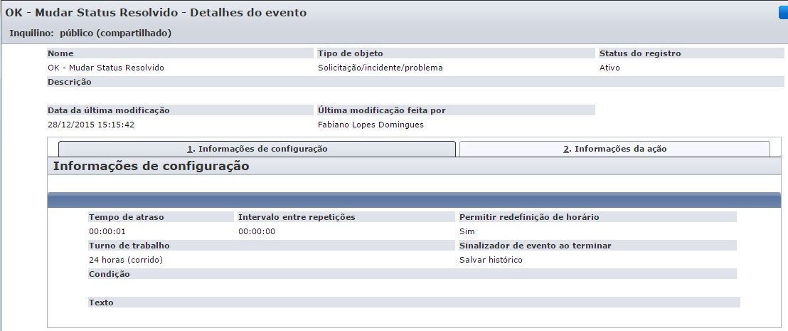

    1 - Create a new Event as the following Example. On "Action guide", click in "Update Actions when True".
    2 - On next screen, find the Action Macro that changes the Status to Resolved (or Closed).This looks like that:
    3 - Click on button OK and Save the Event. You can also modify the Configuration Guide as your needs.

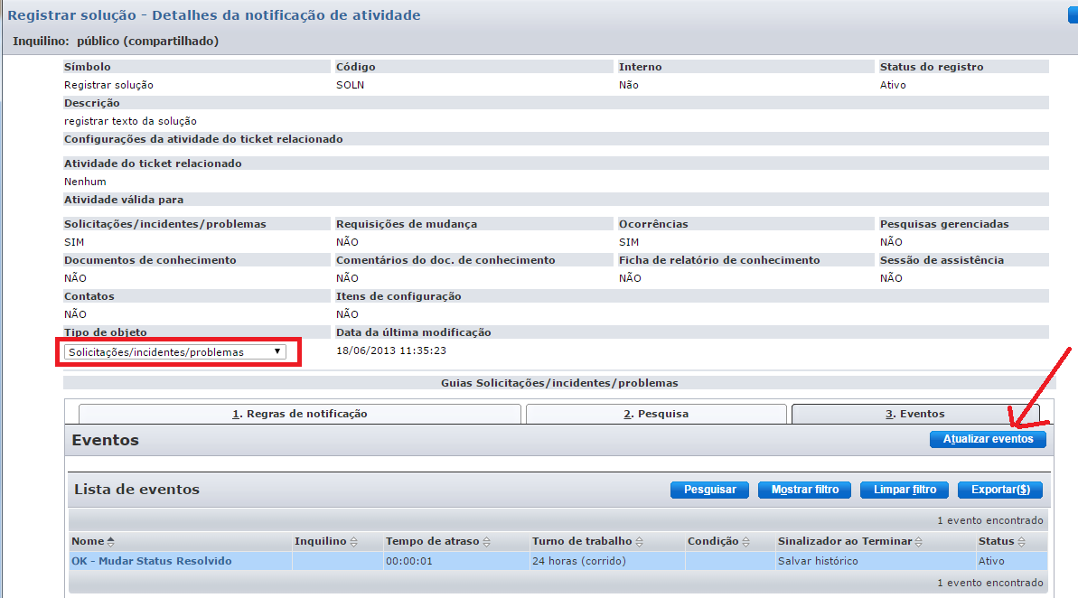

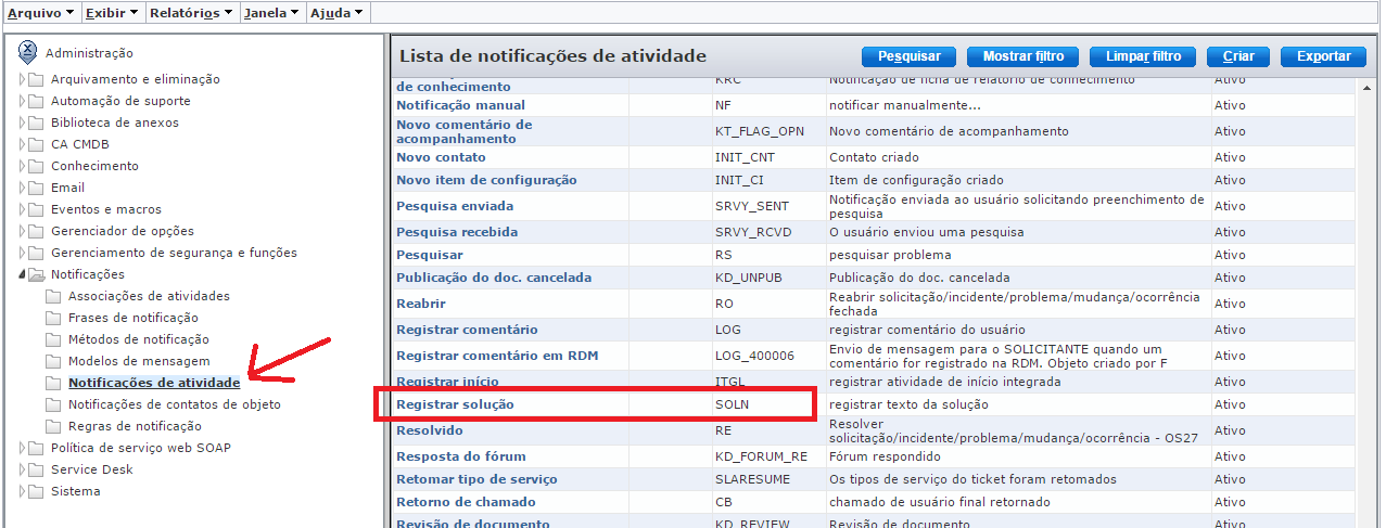

    4 - Now go to Activities Notification and find the object "Register Solution" (code SOLN)
    5 - On button "Update Event", insert the Event that you created.
    Done!
    What the Activities Notification do is execute this Event when a Solution is recorded on ticket. When a solution is register, a log appears on ticket and the Event is actioned. In this case, the status is modified.
