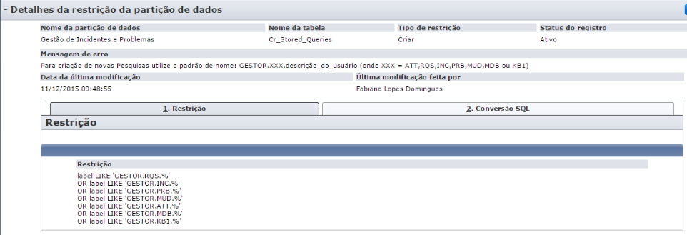

    3 - For Management Roles, we had a requirement. We have Managers distributed in many Processes and we need some way to organize and manage the Stored Queries, avoiding the SDM Administrators to modify personal searches instead queries from standarlized Scoreboard of the operational Roles.
    The solution was a restriction to make standards based on the labels. Here is what we use:

  • 4.  Re: How block users Save Search Filters
    Posted Dec 14, 2015 01:38 PM
    Hello!
    I work for a Brazilian State Company what means here any problem is really big!
    We have many roles but only 2 types: operational roles and managing roles.
    By internal reasons (process definitions) and a big number of SDM users, the operational roles must have the same interface for all Analysts (we have many users with different knowledge levels).
    For this reason, allow the operational users modify or create your own Scoreboards can be a problem. In other words: standardization.
    This problem does not exists in managing role, where the new feature is welcome due the different user profile.
