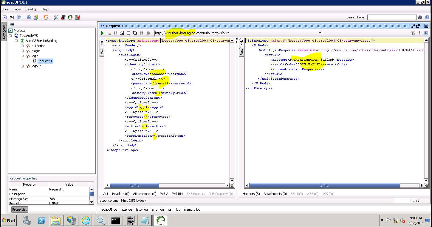

    Anand anand3g
    My AuthAzWS does not throw any errors. Therefore I am good from initiatlization perspective.
    However something weird, SOAP UI says my resource /app1* is unprotected (I have a realm protecting /app1* with Basic Auth Scheme). So I am close, however I guess I am missing something small. The funny part is I don't see any traffic hitting policy server for the /app1 request. So I need to debug further, would see if I could gather more time.
    AuthAzWS.log (DEBUG mode, By default authaz-log4j.xml has INFO, changed it to DEBUG and recycled the SPS Services).

  • 13.  Re: SPS configuration for Web Services
    Best Answer
    Posted Mar 24, 2015 03:53 PM
    Anand anand3g
    Finally it is working.
    Here what we need to do.
    No need to protect the AuthAzWS URL i.e. /authazws/auth for testing purposes. In Prodn we need to protect this using X509 auth.
    Now in the ACO which we are using for AuthAzWS i.e. authaz_aco. Look at the AgentName Parameter. It is wa_authaz_app1,app1
    Create a Policy Domain with a realm, with Basic Authentication Scheme, to protect resource /testpage, with rule /* (with GET POST PUT) and associate wa_authaz_app1 to this realm. Add the rule to Policy and allow all users for now.
    Now open SOAP UI. And use the screenshot above.
    Hopefully you'll be dancing with joy
    Regards
    Hubert

  • 16.  Re: SPS configuration for Web Services
    Posted Mar 27, 2015 12:49 PM
    Just a couple general things I've found from our user of SPS AuthN/AuthZ web services
    • The application object you are using as the 'web service' can use a normal FORMS or RSA auth scheme.
      • Simply adding our already existing RSA authentication scheme to an application object allowed the web service to pass the PIN+TokenCode as the password value to do two-factor authentication
    • If you want the sessiontoken value created by the SPS Web Service to work as an SMSESSION cookie for a Web Agent, you must update the Web Agent ACO for "AcceptTPCookie=yes" . Now if you use the Web Service created token against that Web Agent it should work (assuming authlevel and ssozone are same of course).
      • Have not gotten the other direction working yet for Web Agent token --> SPS unfortunately
    • You can return custom attributes by simply adding them as normal header variables on the application object.
      • For exmaple, I add http header variable for myapp_username. The Web Service will return:
                    <response>
                    <name>myapp_username</name>
                    <value>testuser001</value>
                    </response>
      • Should work with any header variable, at least has for us so far including appending values together etc. Such as taking "username" + @ + "location"
                   <response>
                   <name>myapp_username_location</name>
                   <value>testuser001@Huntsville</value>
                   </response>
  • 17.  Re: SPS configuration for Web Services
    Posted Mar 27, 2015 12:54 PM
    Fabulous Chris CBertagnolli
    It looks like you resolved the other issue of using SESSION generated by AuthAzWS and SSO to Standard WebAgents by setting AcceptTPCookie. Does it work the other way too i.e. an SMSession generated from standard WebAgent and use that in AuthAzWS Request?
    Regards
    Hubert
  • 18.  Re: SPS configuration for Web Services
    Posted Mar 27, 2015 12:57 PM
    Unfortunately the other way not working yet. We're working with CA Support on it; they're the ones that identified the AcceptTPCookie setting since it's using the SDK essentially to create the session.
    If a solution is found will definitely post it out here for everyone. At least for us that's definitely the more useful case if Web Agent session --> AuthAzWs so passing tokens from front-end web apps to downstream services etc allows authn/authz on behalf of some user.
  • 19.  Re: SPS configuration for Web Services
    Posted Mar 30, 2015 09:56 AM
    Thank You Chris, meanwhile am going to paste the reference thread for Session Cookie SSO here. As I have pointed CA Tech Documentation Team to this thread to when they revise the AuthAzWS Documentation (WiKi) "You too have a comment on the WiKi".
    Re: Authentication and Authorization Web Service Session Tokens
    Regards
    Hubert
