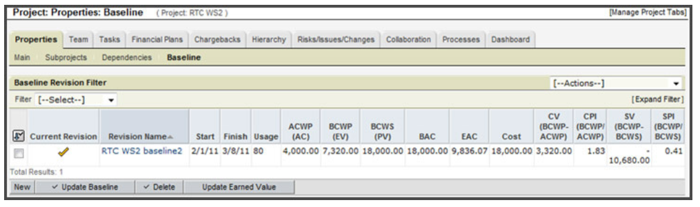

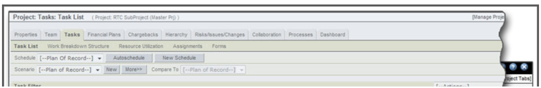

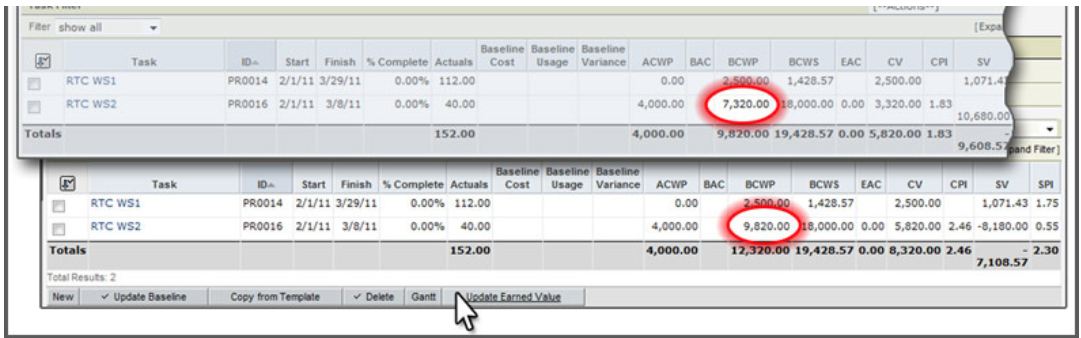

    The following example shows a sample project called RTC WS2. The project has been built and baselined on its own. Click the Update Earned Value button:

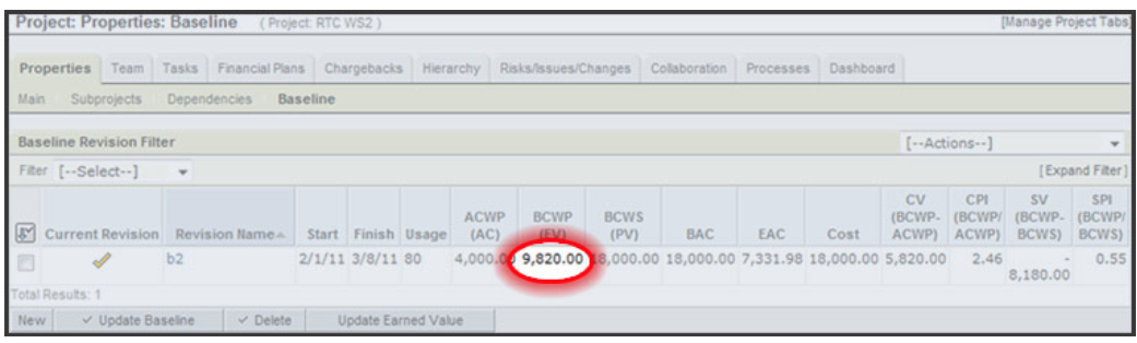

    The RTC WS2 project is added to the master project and is now considered to be a subproject. The % Complete value of a task in WS2 is updated. The following graphic shows the master project Tasks tab before and after clicking the Update Earned Value button.
    Our expectation is that the BCWP of RTC WS2 will be updated when the EV button is clicked. The following graphic shows the result after clicking the master project EV button. The BCWP value is updated in the master project. And, as expected, when we go into the RTC WS2 project, we also see this updated value:

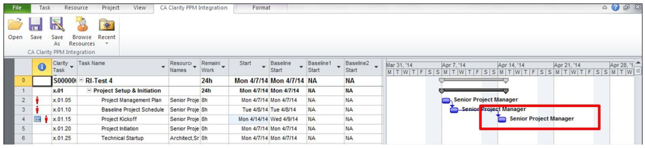

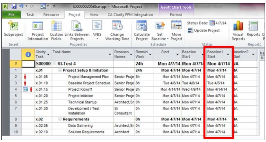

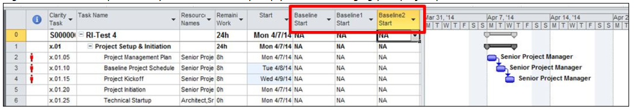

    3. Add the Baseline Start, Baseline1 Start, and Baseline2 Start columns to your Gantt Chart for purposes of this exercise. Revealing these columns is optional for you to decide if they help you when managing your project plan.
    4. Schedule the tasks such that you have some initial dates to baseline.
    5. Save the plan back into CA Clarity PPM and then close the plan in Microsoft Project to release the lock on this project in CA Clarity PPM.

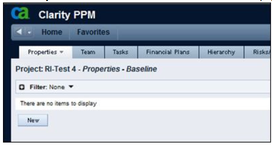

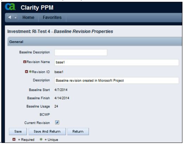

    6. Click Properties and select Baseline. A blank Baseline page appears.

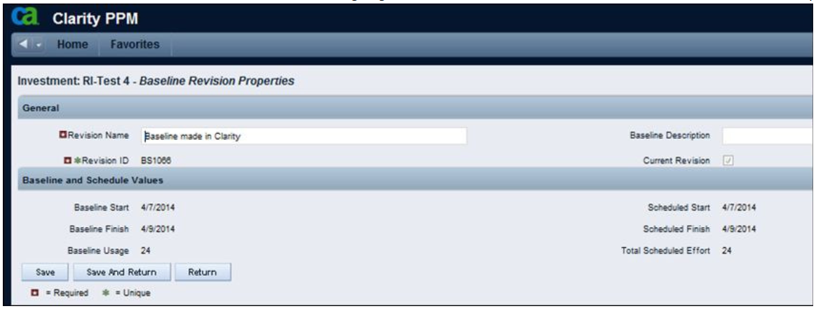

    7. Click New and give the baseline a name (for example, Baseline made in Clarity).
    8. Click Save. The new baseline is marked as the current baseline because there is a gray check in the Current Revision check box. This is true because this is the first baseline created. We are going to create a few baselines in this exercise so this field becomes important.
    9. Later in the week, we update our schedule and update our baseline at the same time. However, in this example, we are going to set the baseline in Microsoft Project. The following steps show how to do this correctly without overwriting the original baseline.
    10. Click Save and Return and open the plan in Microsoft Project. Values that were exported from CA Clarity PPM appear in the Baseline Start column.
    11. Move the last task that you scheduled to fall into the following week.
    12. Baseline the project from Microsoft Project by going to the Project tab and clicking Set Baseline. The Set Baseline dialog box appears.
    13. Select Baseline 1 in the Set Baseline field and click OK.
      CAUTION: If you don’t select Baseline 1 and you baseline the plan with the Baseline value in that field, you will overwrite your original baseline.
    14. Verify that your original baseline values appear in the Baseline Start column and the updated values in the Baseline Start 1 column.
    15. Save the plan back to CA Clarity PPM and close out of the plan in Microsoft Project to remove the CA Clarity lock on the project.
    16. Navigate to the Baseline page. Verify that a new row appears called Base1. The Finish date now reflects the updated schedule’s finish date.
    17. Verify that the original baseline is marked with the Current Revision check. This means that CA Clarity PPM bases its alerts and reveals the baseline values for that baseline version in the portlets and reports. To make the baseline you created in Microsoft Project the baseline of record, click the baseline name, Base1, and select the Current Revision check box. Going forward, that version is the baseline of record.
