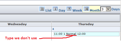

We do not use "Type" on the Change Order form. Therefore I want it removed from the monthly view from the Change Calendar.
I think it related to this piece of code in the list_chgsched_config.htmpl form.
</PDM_IF>
<script type="text/javascript">
// Group change orders by change type (normal, standard, emergency)
function setSchedEvents( chg )
var grpnum;
switch( chg.chgtype - 0 ) {
case 100: grpnum = schedGroup_std; break;
case 300: grpnum = schedGroup_emer; break;
default: grpnum = schedGroup_norm; break;
chg.schedEvent( grpnum, chg.sched_start_date, chg.sched_end_date );
<PDM_IF 0>
My preference would be to replace Change Order Type with Change Order Category. I tried modifying the case statement to use chg.category with no success. I don't know where the values schedGroup_std, schedGroup_emer & schedGroup_norm come from they don't appear when running a pdm_extract usp_change_type and I cannot see their reference in the schedule_chg.js or list_chgsched.htmpl forms.
Any advice ?
Thanks
