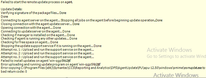

    I tried to run on the agent which is faster. The job is completed but when I check the management task status at Asset System/ Agents
    I get below this
    Is there any configuration I need to set on the agent asset or open port or unblock firewall etc.
    Thanks!
  • 8.  RE: Agent Product Update is not available for deployment
    Posted Jul 21, 2020 03:30 AM
    Hi Ong,
    agent update requires port tcp/5599 opened on the agent side, maybe that is causing the issue. Ensure that your network and host firewall allow CCS Manager to connect to CCS Agent over port tcp/5599.
