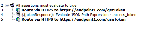

    The policy would look something like this.
    Breakdown:
    Line 2: We want all assertions to succeed

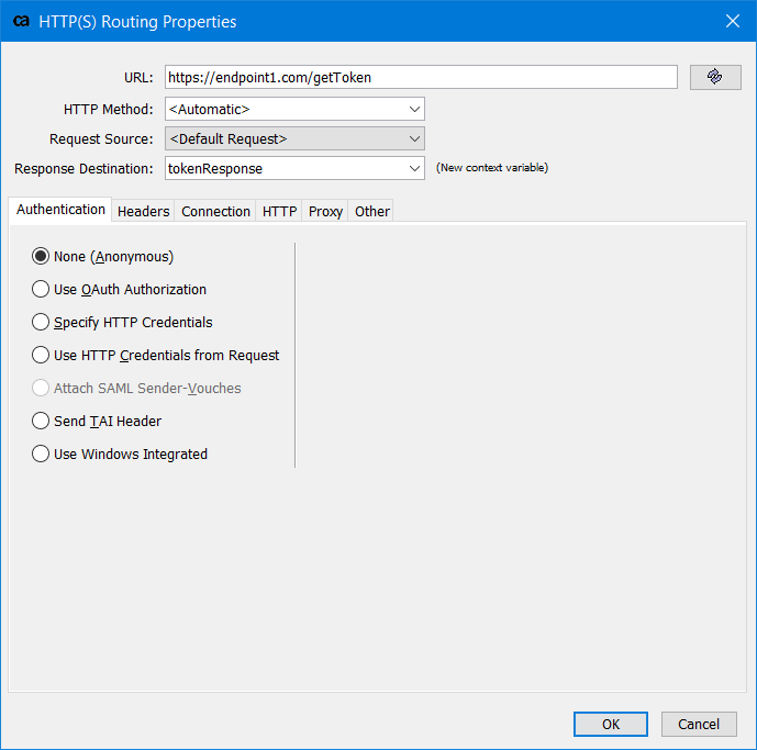

    Line 3: Route to the endpoint that gets the Token
    Here in the HTTP route properties we can capture the response in the Response Destination field. Simply enter a name and the variable will be created if it does not exists. So if this endpoint returns the JSON in my example above it will be put into the variable tokenResponse
    Line 4: We use an Evaluate JSON Path Expression to get just what we need from the JSON.

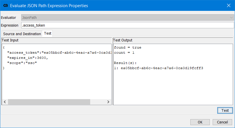

    For my example we just want the value in "access_token", so a simple expression is .access_token
    To make sure this acts against the variable (tokenResponse) we got from the route assertion, simply right click on the Evaluate JSON path and click on 'Select Target message', you can now set this to the variable

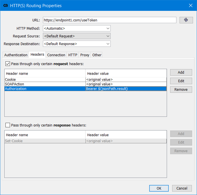

    Line 5: Route to the destination that requires the token
    Here we can include the header with the new variable we got from the JSON path exression
