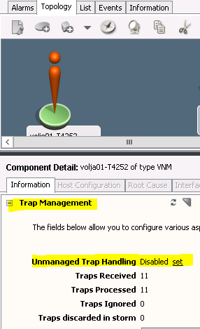

    First you can try disabling Unmanaged Trap Handling and see if that helps the server stay up. Setting is on VNM model > Trap Mgmt subview

     I am starting the SpectroSERVER with the Spectrum Admin account and I did load a good backup after the crash.
    I have disabled Unmanaged Trap Handling.

    Database" in the Event Configuration utility in OneClick.
    Hope this helps
    Sunny
