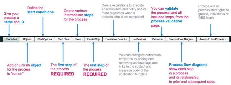

Once we have verified the correct security rights have been added, we can create a process. Navigate to Administration à Processes (under the Data Administration header) in CA PPM and click the “New” button. You will be asked to give your process a name and an ID. Once you click “Save and Continue,” you will see all the process tabs across the top of the page. This diagram provides each tab’s definition and relevance.
(The red and blue text signifies the basic elements for building our process knowledge foundation.
The gray text signifies elements that are a little more advanced.)
As you create your process, you will proceed in the order of the tabs from left to right. For example, we would first give our process a name and ID on the Properties tab. Next, we would link our process to an object on the Objects tab and then define our start conditions…and so forth.

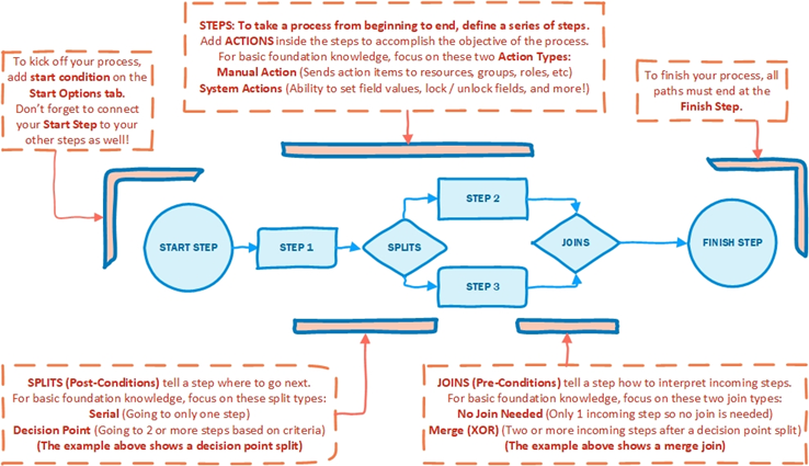

To help you understand the building blocks of processes and how they connect to the tabs above, I’ve created the diagram below. We start out with a process flow from Start Step to Finish Step with an emphasis on building a foundation and an understanding of Steps, Step Actions, Splits and Joins.
By using the process building blocks illustrated above, you’ll be well on your way to understanding workflows and creating your own.
