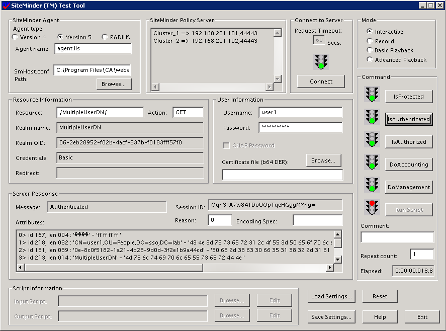

Above is a "CN=user1,OU=People,DC=sso,DC=lab" being authenticated.

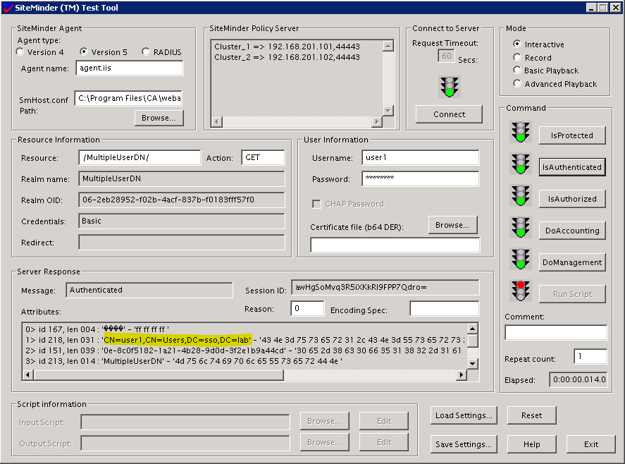

Above is for "CN=user1,CN=Users,DC=sso,DC=lab".
So, depending on which user's password you enter, that maching user will be authenticated.

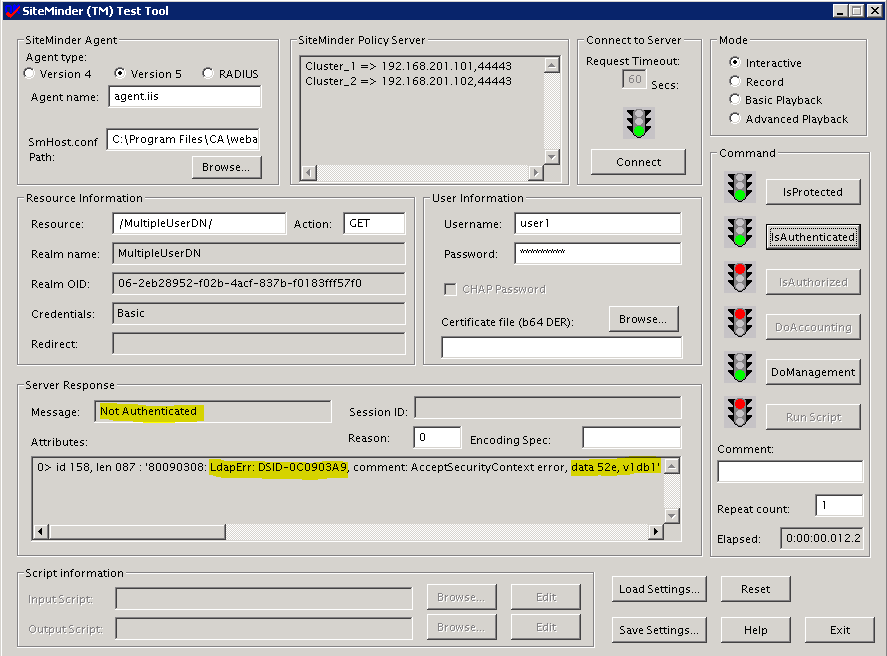

Next question is... what happens if user1 enters wrong password that does not match either of the users.
The user is not authenticated. It doesn't look too bad, right?

Now that I have your attention, let's look at the smps.log before we go further.
#1. Initially I logged in as "CN=user1,OU=People,DC=sso,DC=lab"
#2. Then login as "CN=user1,OU=Users,DC=sso,DC=lab"
#3. Lastly, I logged in with wrong password that does not match either users.
smps.log
[6340/4144][Wed Aug 03 2016 16:20:27][SmAuthServer.cpp:361][INFO][sm-Server-02760] Initialized authentication scheme Basic
[6340/1128][Wed Aug 03 2016 16:22:17][plugin_AD.cpp:1689][ERROR][sm-Ldap-00770] (AuthenticateUser) DN: 'CN=user1,OU=People,DC=sso,DC=lab' . Status: Error 49 . 80090308: LdapErr: DSID-0C0903A9, comment: AcceptSecurityContext error, data 52e, v1db1
[6340/4140][Wed Aug 03 2016 16:24:40][plugin_AD.cpp:1689][ERROR][sm-Ldap-00770] (AuthenticateUser) DN: 'CN=user1,OU=People,DC=sso,DC=lab' . Status: Error 49 . 80090308: LdapErr: DSID-0C0903A9, comment: AcceptSecurityContext error, data 52e, v1db1
[6340/4140][Wed Aug 03 2016 16:24:40][plugin_AD.cpp:1689][ERROR][sm-Ldap-00770] (AuthenticateUser) DN: 'CN=user1,CN=Users,DC=sso,DC=lab' . Status: Error 49 . 80090308: LdapErr: DSID-0C0903A9, comment: AcceptSecurityContext error, data 52e, v1db1
For #1, although 2 UserDNs were returned, because the first userDN("CN=user1,OU=People,DC=sso,DC=lab") was able to successfully BIND with the password, the next userDN was not tried.
As a result, in the smps.log you do not see "Error 49" for any user.
** The order of which UserDN returns first cannot be expected. It may be different on every request.
For #2, this time the first UserDN(This time it was "CN=user1,OU=People,DC=sso,DC=lab") did not successfully BIND using the password so it logs "Error 49" and continue to try with the next UserDN.
As a result, in the smps.log, you will see "Error 49" for "CN=user1,OU=People,DC=sso,DC=lab"
For #3, regardless of in which order the 2 UserDNs were returned, they all failed to BIND.
As a result, you will see "Error 49" for both users.

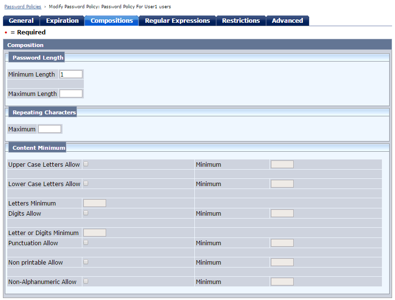

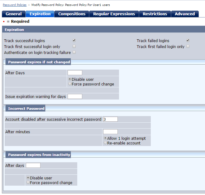

Following password policy is created.
As you can see that this only applies to "CN=User1"
AD has its native password policy but SiteMinder password policy will trigger first because AD is not configured to lock out users due to incorrect passwords.

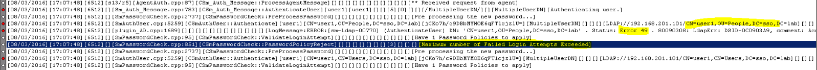

You can see from above smtracedefault.log (using authentication_trace.template) that both users get "Have 1 Password Policies to apply" message.
But only the first UserDN gets "Incrementing Failed Login Attempts Counter" message.

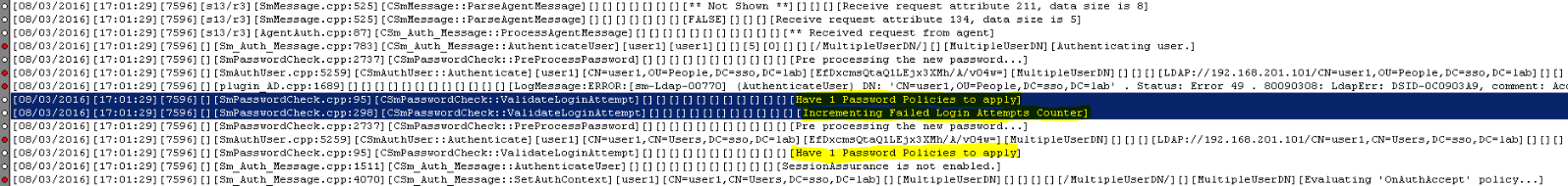

Now you can imaging what will happen when the "CN=user1,CN=Users,DC=sso,DC=lab" successfully authenticates several times exceeding the password policy.
As you can see from above, "CN=user1,OU=People,DC=sso,DC=lab" got locked out.

For #3, both users would have their "Failed Login Attempts Counter" increased.
As you can see from above, "CN=user1,OU=People,DC=sso,DC=lab" is already disabled.
"CN=user1,CN=Users,DC=sso,DC=lab" had "Failed Login Attempts Counter" increased.
