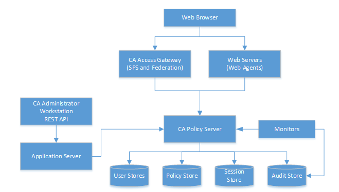

Here’s a simplified reference architecture to build out the new solution:
With the latest version of CA SSO, administration tasks can be done using REST API calls. Also, new capabilities of CA SSO include REST API-based Authentication and Authorization as well as being an OpenID Provider.
