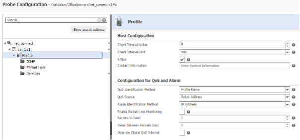

This will output the value of the /profiles/centos1/active key:
Active: "yes"
You can view the Active value in Admin Console or Infrastructure Manager:
ESD_FY25_Academy-Blog.Unlocking the Power of UIMAPI - Automating Probe Configuration.Figure 2

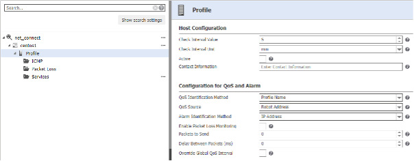

Active: "no"
ESD_FY25_Academy-Blog.Unlocking the Power of UIMAPI - Automating Probe Configuration.Figure 4

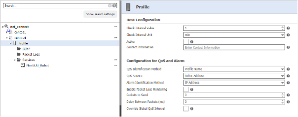

This will output the following Return Code:
Return Code: 204
You can view the new centos4 profile in Admin Console or Infrastructure Manager:
ESD_FY25_Academy-Blog.Unlocking the Power of UIMAPI - Automating Probe Configuration.Figure 5
