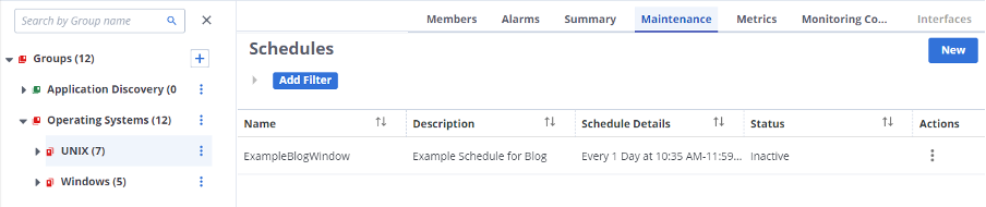

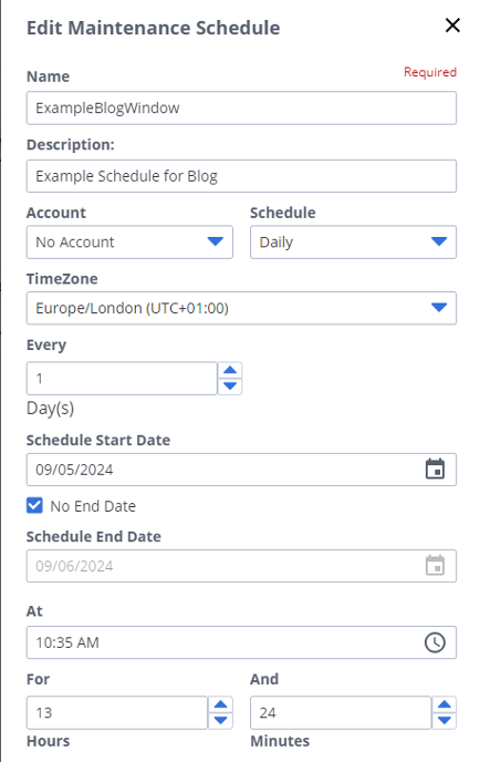

You can view the schedule in the Operator Console by selecting a group and navigating to Maintenance:
ESD_FY24_Academy-Blog.Streamline Your Maintenance Modes - Automate DX UIM with UIMAPI.Figure 2
Edit Maintenance to view the details:

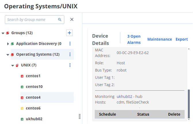

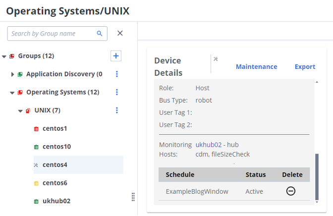

This can be viewed in the schedule:
ESD_FY24_Academy-Blog.Streamline Your Maintenance Modes - Automate DX UIM with UIMAPI.Figure 4
Viewing the device details will show the maintenance schedules for this device:
ESD_FY24_Academy-Blog.Streamline Your Maintenance Modes - Automate DX UIM with UIMAPI.Figure 5
ESD_FY24_Academy-Blog.Streamline Your Maintenance Modes - Automate DX UIM with UIMAPI.Figure 6

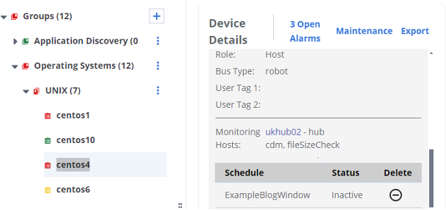

The device is removed from the schedule and no longer in maintenance mode:
ESD_FY24_Academy-Blog.Streamline Your Maintenance Modes - Automate DX UIM with UIMAPI.Figure 7
Viewing the device details will show there are no maintenance schedules for this device:
ESD_FY24_Academy-Blog.Streamline Your Maintenance Modes - Automate DX UIM with UIMAPI.Figure 8
