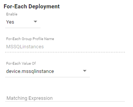

As shown below, to use the For-Each we need to set “Enable” to “Yes.” Now, give the For-Each Group profile a name in the “For-Each Value Of” drop-down. Select the device attribute from the list; in this example, we are using an MCS device custom attribute created in the “MCS Device Custom Attributes” section with the list of MS SQL Server instances “device.mssqlinstances.” You can also use the “Matching Expression” to filter that list even further, but for this example we don’t need to.

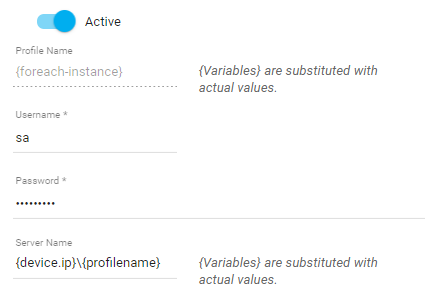

Now that the For-Each set up is complete, you need to associate the For-Each value to the SQL Server profile name. This value will always be {foreach-instance}. MCS will substitute the profile name with each different value it finds in the custom attribute you set up. If you need to use that same value in the profile itself, you can use {profilename}, as this is now set with that value. In the Server Name field we can use two variables, {device.ip} and the instance name which is now the {profilename}, and format this like {device.ip}\{profilename} as shown below.
ESD_FY22_Academy-Blog.How to Use the For-Each Feature with the UIM Monitoring Configuration Service.Figure 3

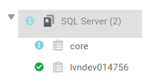

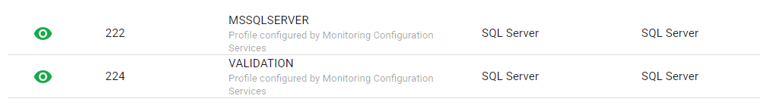

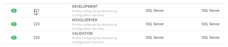

For this example, one group profile has created five profiles over two devices as shown below.
ESD_FY22_Academy-Blog.How to Use the For-Each Feature with the UIM Monitoring Configuration Service.Figure 4
ESD_FY22_Academy-Blog.How to Use the For-Each Feature with the UIM Monitoring Configuration Service.Figure 5

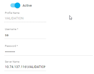

If we look at one device profile below, you will see the actual values used from the attributes:
ESD_FY22_Academy-Blog.How to Use the For-Each Feature with the UIM Monitoring Configuration Service.Figure 6

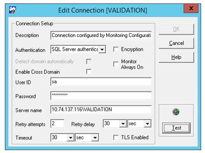

If we look at the probe UI, you can see it is configured as we wanted.
ESD_FY22_Academy-Blog.How to Use the For-Each Feature with the UIM Monitoring Configuration Service.Figure 7

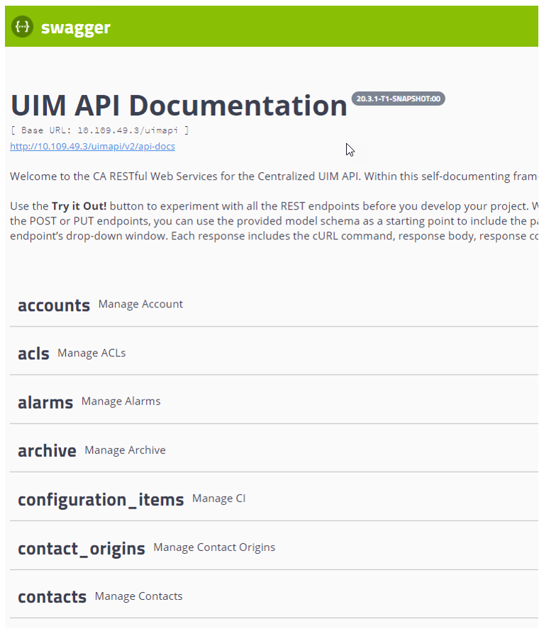

Any RESTful tool can be used to GET the device and PUT the updates to the device. There is also a swagger page to use:
http://<hostname>:<port>/uimapi/swagger-ui.html
ESD_FY22_Academy-Blog.How to Use the For-Each Feature with the UIM Monitoring Configuration Service.Figure 8

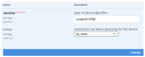

Select the deviceoperations and GET / deviceoperations/{identifier}, Try it out. Enter the device name and choose the lookup by_name then Execute.

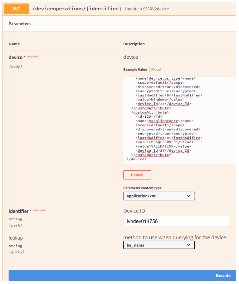

Using the Swagger page, select the “deviceoperations” and PUT / deviceoperations/{identifier}, Try it out. Enter the device name and choose the lookup by_name, paste the entire GET device output with your new device custom attribute(s), then Execute.
ESD_FY22_Academy-Blog.How to Use the For-Each Feature with the UIM Monitoring Configuration Service.Figure 10
Note: this should get a 204 return code

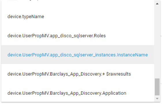

Your device attribute will appear in the “For-Each Value Of” drop-down list for you to use:
ESD_FY22_Academy-Blog.How to Use the For-Each Feature with the UIM Monitoring Configuration Service.Figure 12
