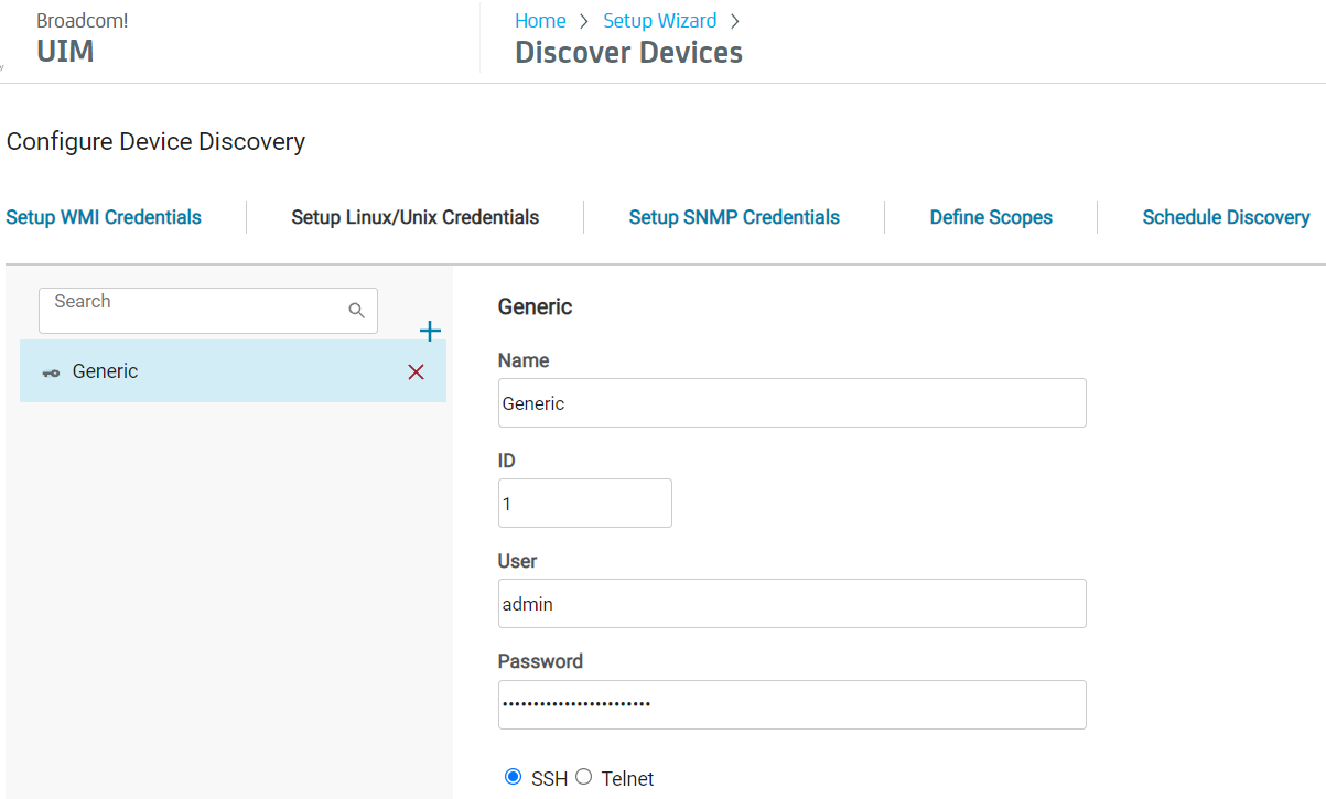

Figure 1: In the Discover Devices Setup Wizard, you can add credentials (Windows, Unix, and SNMP) for the wizard to use and define the network scopes to search.

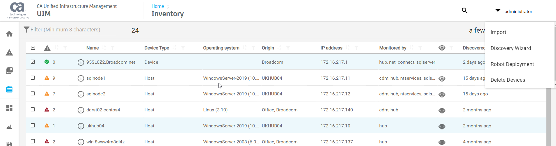

ESD_FY21_Academy-Blog_Making Zero-Touch a Reality with DX Unified Infrastructure Management.Figure_02
Figure 2: In the Inventory view, users select a device without a robot. The Robot Deployment option is available in the menu.

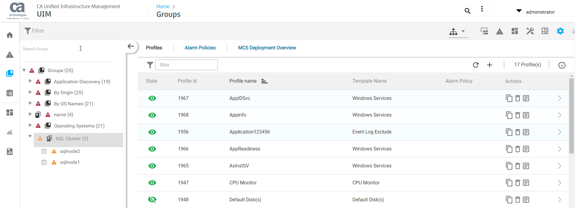

Figure 3: The Monitoring Configure page displays the profiles associated with the SQL Cluster group. Each of these profiles will be deployed to all devices in the group.

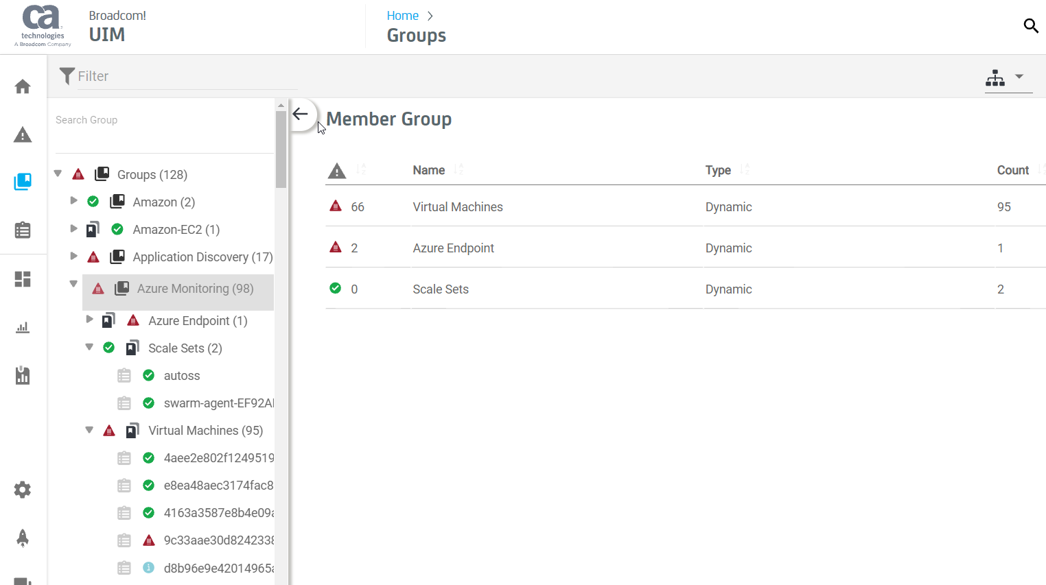

Figure 4: In this Group tree view, Azure Monitoring is a container group because it has other groups below it. The other groups are either static or dynamic groups as they have devices in them.

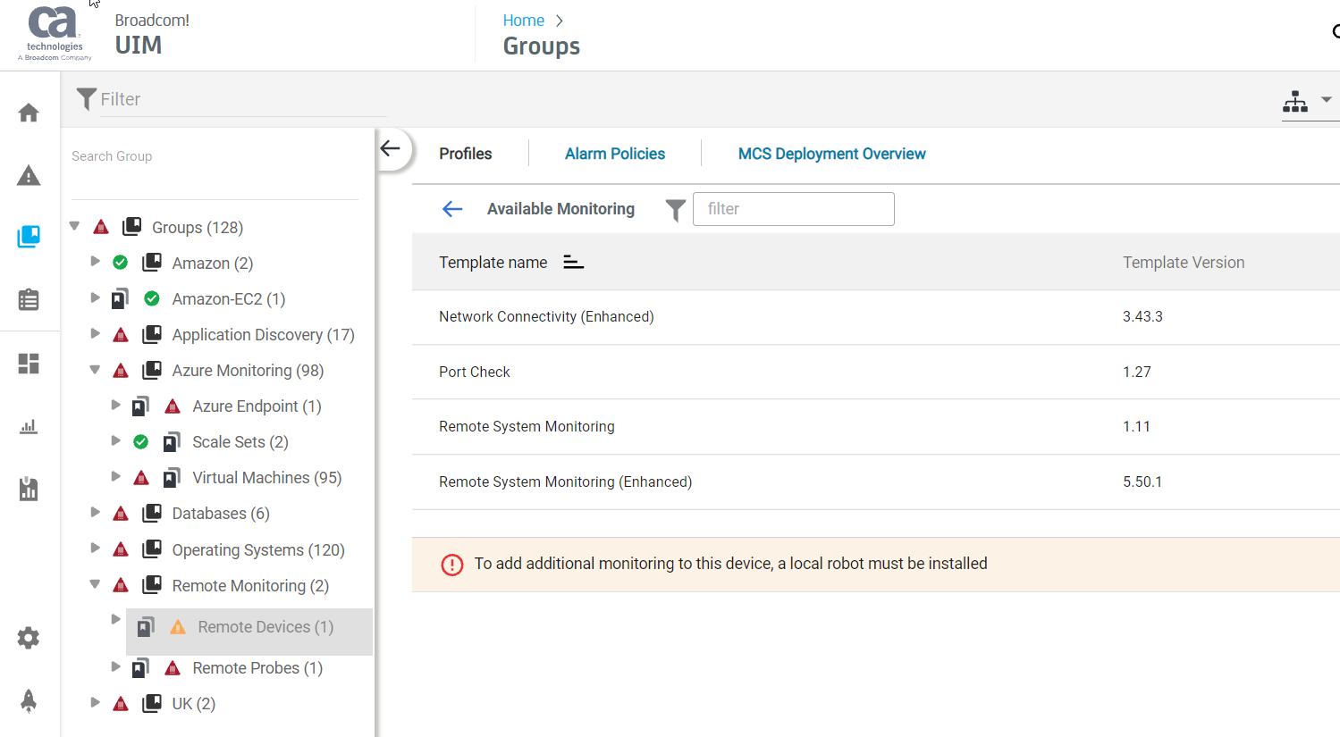

You can also have groups of agentless devices but only the agentless profiles will be configured for these devices. These are known as remote profiles as they will configure a probe, but that probe will not reside on that agentless device. All probes that can monitor remote devices must be installed on a proxy robot before you can enable the remote monitoring. To do so, you will be asked to select the device from a dropdown menu, which is made up of robots that have at least the “Setup {probename}” profile installed.

Figure 5: The Remote Devices Group featured has a limited set of monitoring available as no robot is installed on the device in the group.

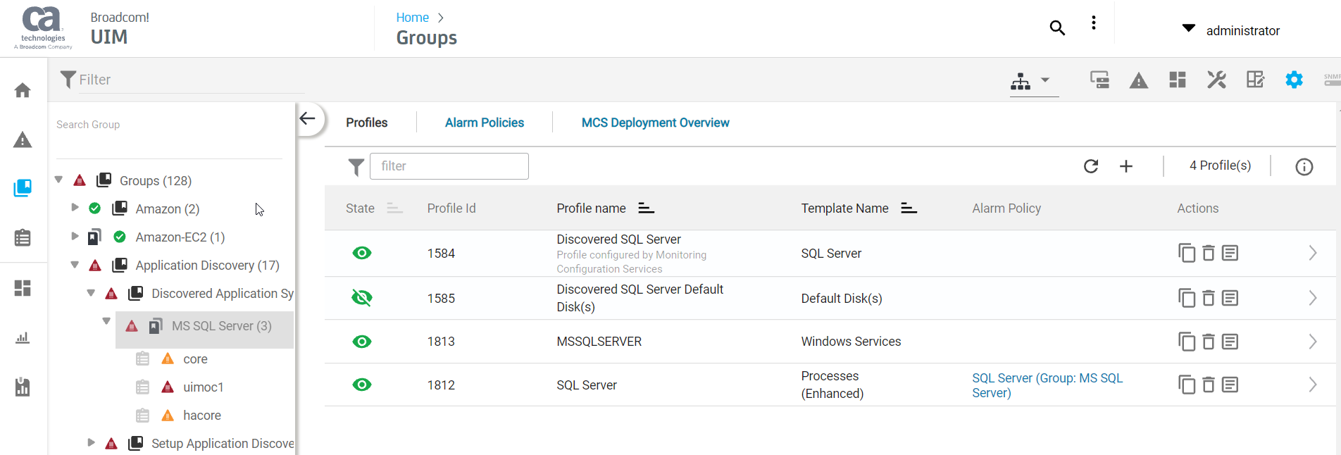

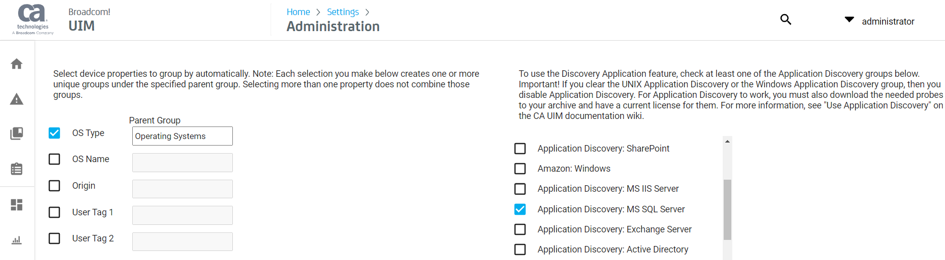

Figure 6: Users can configure options from the Settings menu. In the example above, we have enabled the discovery of MS SQL Server.
ESD_FY21_Academy-Blog_Making Zero-Touch a Reality with DX Unified Infrastructure Management.Figure_08
Figure 7: By enabling Application Discovery of MS SQL Server, a MS SQL Server dynamic group is created. Once the application discovery scripts have been executed, devices found to have MS SQL Server are added to this group, and monitoring profiles will be configured and deployed.

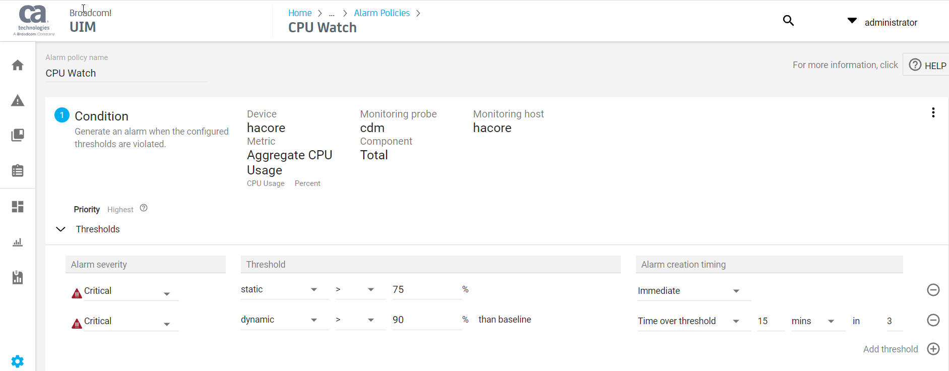

When using enhanced templates, alarm policies are created by default as you enable your monitoring policies. These policies establish default thresholds for your metrics. However, you can manage all aspects of alarm behavior in an alarm policy. For example, you can configure an alarm’s thresholds, timing, and messages. The alarm policies configure the spooler on each robot so when the spooler receives a metric it can determine if a threshold breach occurs and if an alarm should be created.
ESD_FY21_Academy-Blog_Making Zero-Touch a Reality with DX Unified Infrastructure Management.Figure_09
Figure 8: An example of a device alarm policy, displaying the Aggregated CPU Usage with two thresholds (static and dynamic).
