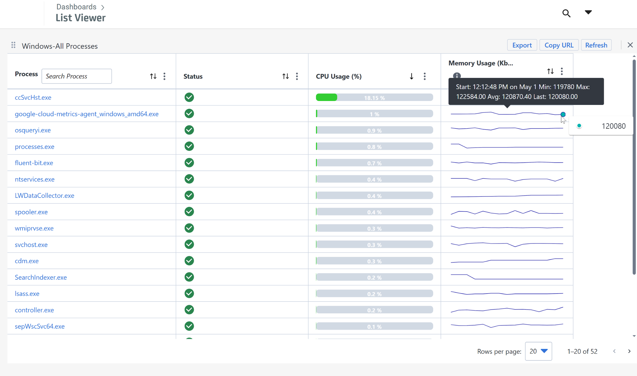

A few words about the CDM Probe for DX UIM
In conjunction with the processes probe, customers can also leverage the CPU, Disk, and Memory Performance Monitoring probe (cdm) for early warnings when top processes consume significant server resources.
This probe monitors performance and resource load on the system with the robot. It generates alarms that are based on configured threshold values and can trigger corrective actions. cdm also generates trending quality of service (QoS) data.
Customers use cdm for tasks such as:
  • Viewing how disks are filling up over time.
  • Planning batch jobs according to the CPU utilization.
  • Upgrading systems that consistently operate near capacity.
  • Sending alarms when the top five to 10 processes on a server are consuming an unusual percentage of resources.
  • Performing capacity planning by using cdm historical data gathered from monitored systems.
ESD_FY25_Academy-Blog.Process Monitoring – Huge Value from a Quick Task.Figure 1
The cdm probe and processes probe are complementary. In addition to using the processes probe to monitor all or some processes that end up using a high percentage of physical memory available, the cdm probe may be used as well. For example, the cdm probe can be used to leverage the “Memory usage option” and include the “Top memory consuming processes in alarm” (up to 10 processes), for the alarm that is generated.
