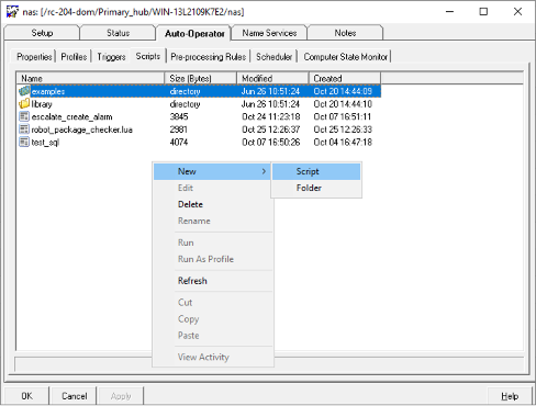

To implement this in the Script tab of NAS/Auto Operator configuration (available only in Infrastructure Manager):
  1. Right-click and select New Script.

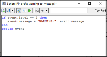

  2. Create the following LUA script:
    ESD_FY25_Academy-Blog.Power Up Your Alarms.Figure 2

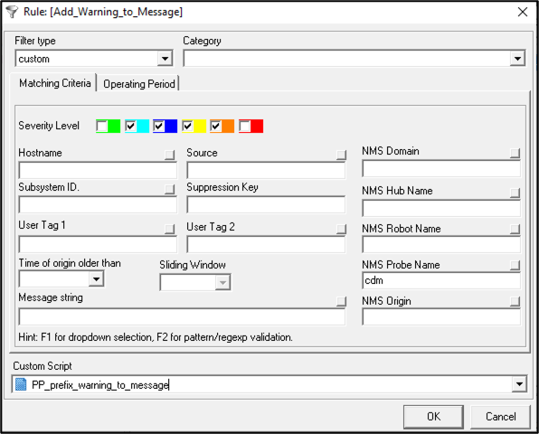

  3. Create the following Pre-Processing Profile:
    ESD_FY25_Academy-Blog.Power Up Your Alarms.Figure 3

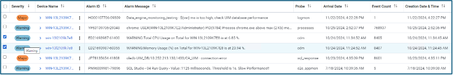

As per the above profile, all Warning (level 2) alarms from the cdm probe will be prefixed with WARNING:
ESD_FY25_Academy-Blog.Power Up Your Alarms.Figure 4

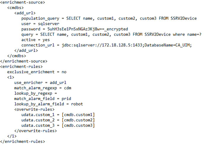

Note: This probe is unique as it isn’t configured through its local .cfg file; instead, it relies on keys in NAS.cfg within specific sections:
ESD_FY25_Academy-Blog.Power Up Your Alarms.Figure 5
This configuration can only be achieved using the Raw configure in either Infrastructure Manager or Admin Console. Alternatively, you can edit the NAS.cfg directly on the Primary Hub, following with a restart to re-read the cfg file.
Enrichment-source section
Here, data sources and queries are configured along with connection strings to databases and credentials.
Key
Value
Connection_url
jdbc:sqlserver://172.x.x.x:1433;DatabaseName=CA_UIM;
User
Sqlserver_account
Password
password
Population_query
SELECT name, custom1, custom2, custom3 FROM SSRV2Device
Query
SELECT name, custom1, custom2, custom3 FROM SSRV2Device where name=?
Active
yes
Connection_url—The data may not yet exist, therefore the implementor can point to a remote database or a newly created table in the DX UIM database.
The Population Query caches data from this table; subsequently, a specific Query retrieves data for actual configuration items (CIs).
The Query is used to select a single row of data, which is to be used to insert into the Alarm. The ‘?’ should be substituted with what as been defined in the lookup_by_alarm_field key.
The password field is encrypted when the NAS restarts.
Enrichment-rules section
This section consolidates everything. The Use Enricher key specifies which database and query to use for data retrieval as defined in the Source section.
Match_alarm_field indicates which field to select alarms on—typically Prid (probe).
Match_alarm_regex defines regex patterns for selecting multiple values.
Lookup_by_alarm_field specifies which field will have its values substituted in queries for enrichment.
Key
Value
Use_enricher
Add_url
Match_alarm_regexp
cdm
Lookup_by_regexp
Match_alarm_field
Prid
udata.source
Overwrite-rules
         udata.custom1
[cmdb.custom1]
         udata.custom2
[cmdb.custom2]
         udata.custom3
[cmdb.custom3]
The [cmdb.*] are the fields retrieved from the database lookup and, in the above example, are placed in the matching custom fields in the alarm. The fields may be overwritten but be careful not to lose alarm key data.
